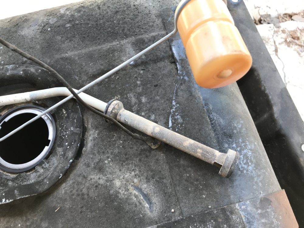

I would check for a clogged screen on pickup tube in gas tank and maybe rust or debris in tank
This. Check the strainer screen in the tank, also check the short piece of rubber hose on the sending unit that connects between strainer and sending unit.
If that rubber hose isn’t rated for ethanol, and has seen some ethanol it will swell up and choke down on fuel supply. It can also squeeze down more with mech pump bc it’s sucking fuel, not having fuel pushed through it.

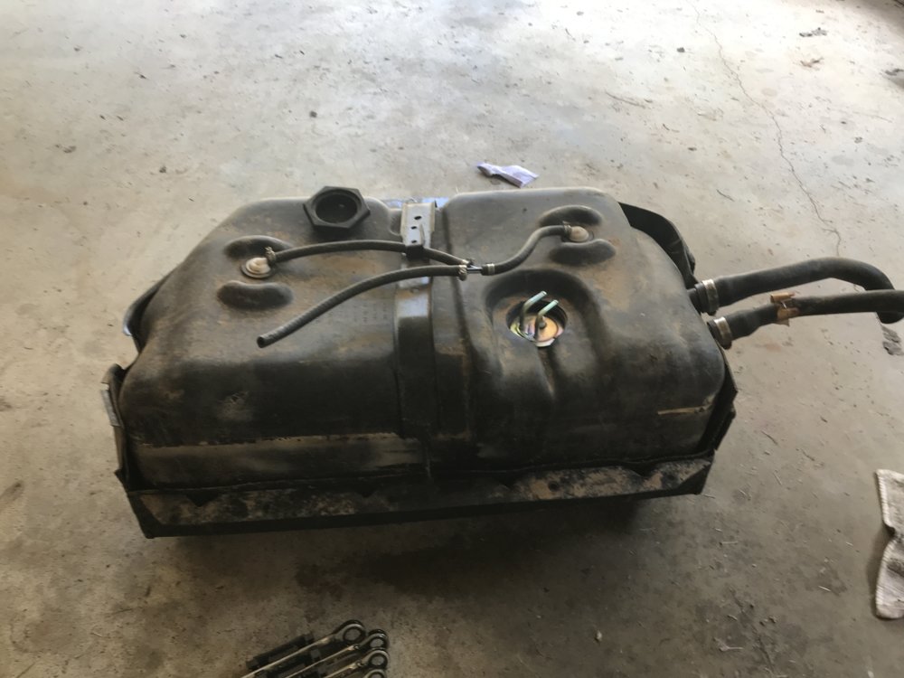

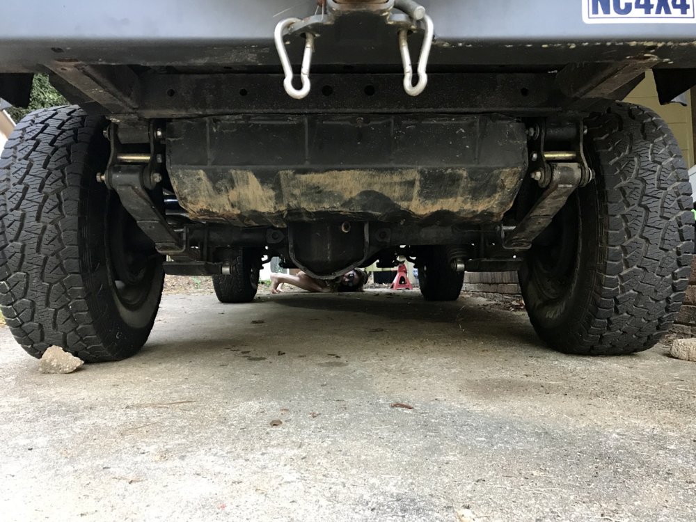

Had enough time to drop the tank today.

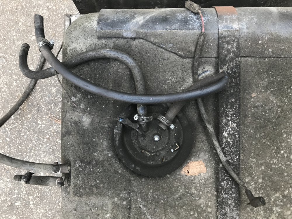

Haven’t opened it up yet, but this surely wasn’t helping. Return line.

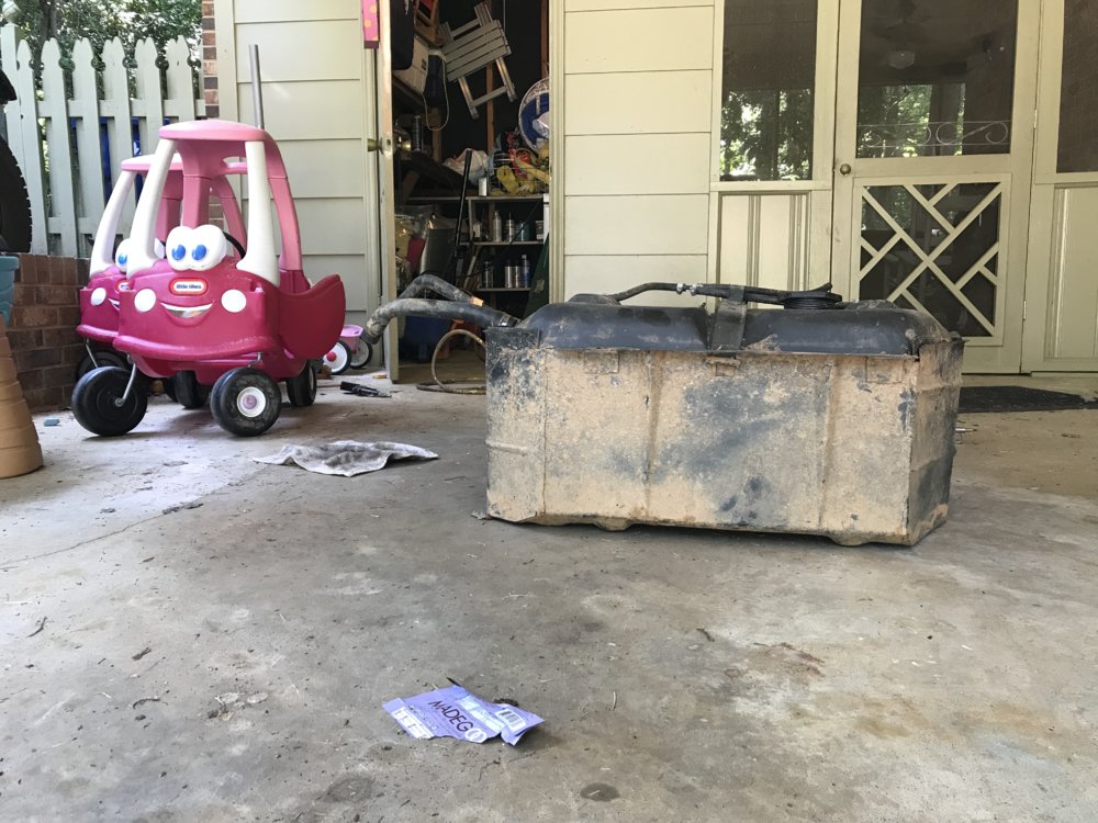

Opened the tank up. The filter sock is completely gone from the 15 gallon tank. The inside of the tank looked brand spanking new.

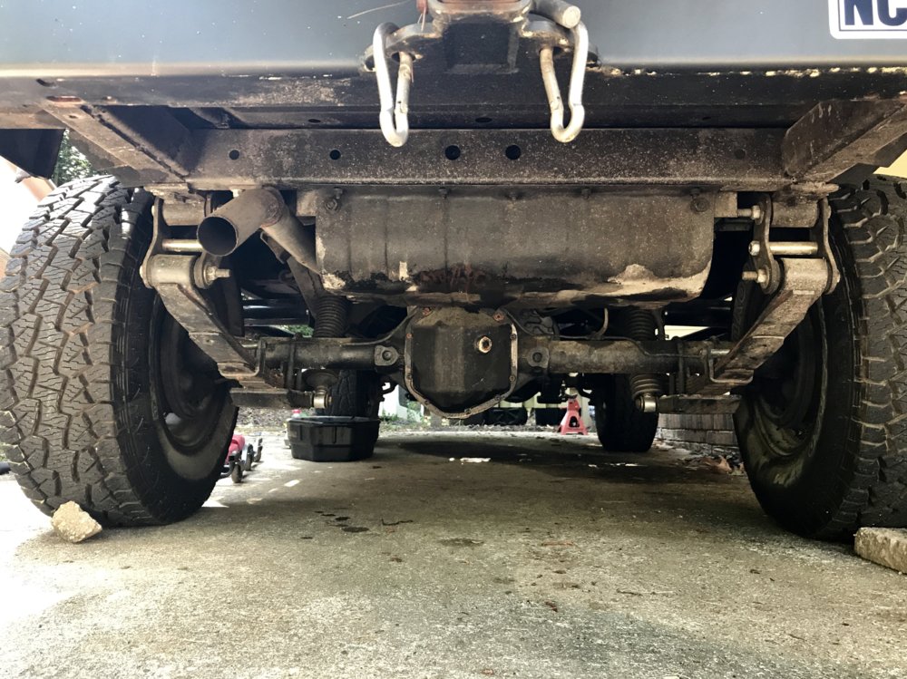

But I picked up @adman02 old 20 gallon CJ tank and swapped them out. New lines and wiring across the top and the sending unit looked brand new. I’m going to drive it around with the new tank this week to see how it goes.
Hey. Whatcha gonna do with that 15 gallon tank? Turns out I just picked up a scrambler that needs a new tank and skid plate. : )
