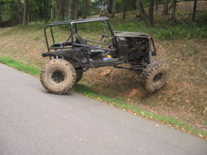

poser shot on the bank, couldn't find anything else but trees to drive up and don't trust it pointed that steep and me out of it, would suck if it ended up in the yard below me.

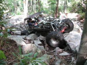

comin out of the creek on the left exit. Didn't make it but got the front wheels up on top.

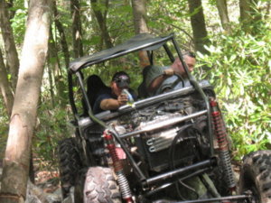

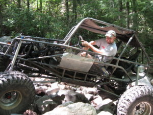

My buddy Hareball's buggy working pull cable. He didn't have any problems till he started overheating. What fun would it be if everything went perfect.
