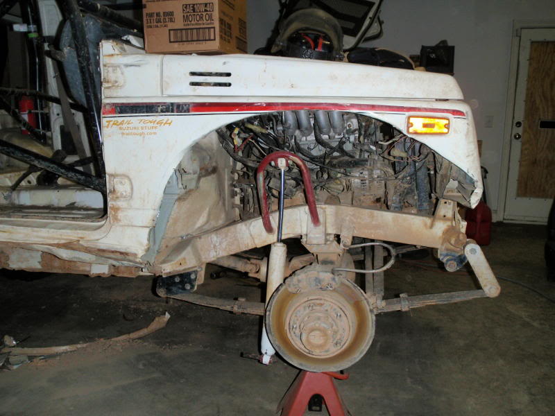

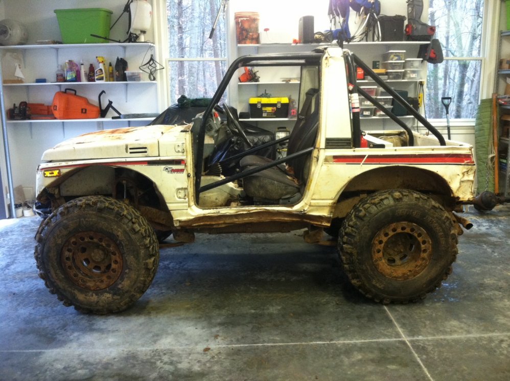

I'm still running Samurai axles, but have the YJ leaf springs still in a spring under position. It flexes awesome, and due to still being so low, is extremely stable. I had to cut the body pretty heavily to fit bigger tires though.
I'm running 34" LTB tires. I'm running the stock axle gears (3.73), but 6.5:1 TC gears. Here is a picture:

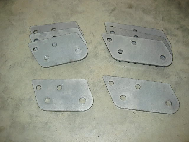

Springs hangers I got cut on the laser at work:
ai34.photobucket.com_albums_d117_drkelly99_Samurai_Buildup_Suspension_20mods_IMGP1362.jpg

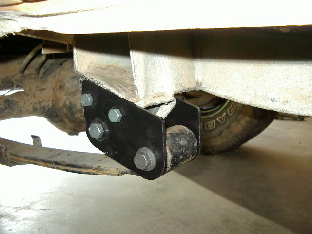

Relocation brkt bolted up:
ai34.photobucket.com_albums_d117_drkelly99_Samurai_Buildup_Suspension_20mods_IMGP1374.jpg

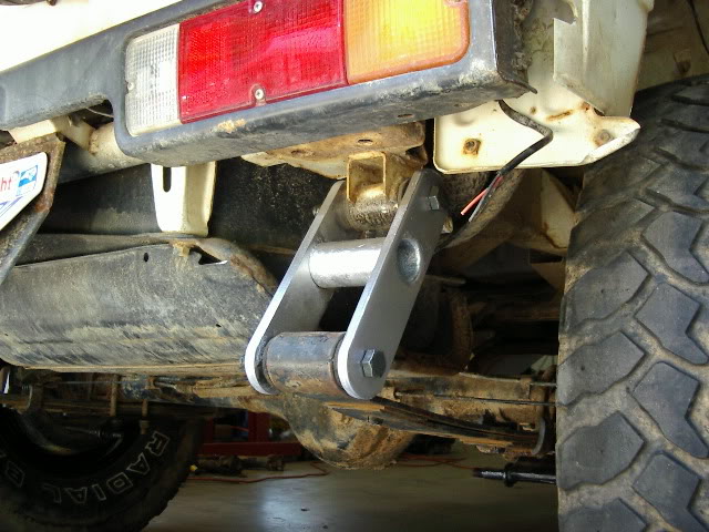

These are YJ heavy duty shackles I used on the rear:
ai34.photobucket.com_albums_d117_drkelly99_Samurai_Buildup_Suspension_20mods_IMGP1376.jpg

I like That setup. Do you have measurements or template for your relocation brackets? also what thickness steel did you choose?
I might be able to find my old CAD files and get some measurements. I will look and report back.
My front relocation brackets are different from the rear ones. I designed them to put the center pin of the YJ springs in the stock Sami position. I then redrilled the spring perches to move the front axle forward and rear axle reward about 1". I used 1/4" thick steel.
