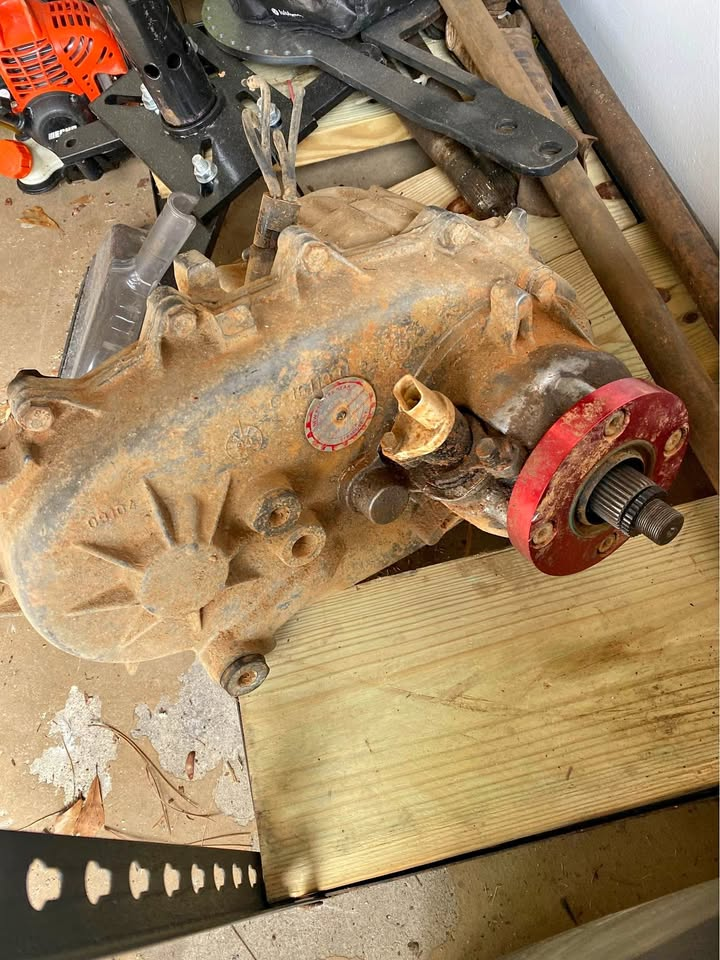

Looking for a sought case to go behind the 5.9 magnum with the AX-15. Long term goal will be a NWF Ecobox and a 241 internals. SO I'd love to get out that can go straight in and work until funds free up for the double set up. I came across a 241J on MP. When and where did Jeep use these? I know about the 241 OR and this isn't that. My search has been centered around the 241D since I have one in a XJ right now. So I'd need 23 spline input and fixed output yokes. The problem with the 241D is it has slip front and rear outputs.

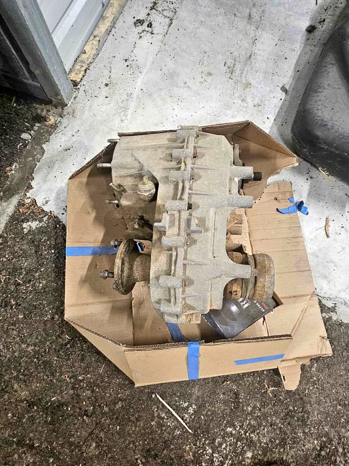

The one you posted is a JK 241. Nothing wrong with them or anything. You'll want to verify the input shaft spline count and make sure it's 23. In 2012 when they went to the 3.6 V6, the automatic they used was 26 spline. Basically 07-11 will be the same spline if auto and AFAIK the manuals were all 23 spline.
Verify the protrusion on the input too and make sure it'll engage the seal in the extension housing.
You may be better off with an upgraded manual trans 231 to be honest (or a TJ Rubi case).
The other thing with a JK case is adapting the speedo function if you need one for PCM functionality. The JK don't have a VSS in the case like pre-JK did.

So I may be on the cusp of a good deal. Found this 241 on MP for $200 in GA. 241 with SYE for $200. So I messaged the guy and finally heard back today. If all goes well my buddy Ga Mike will grab it for me in the next couple days.
