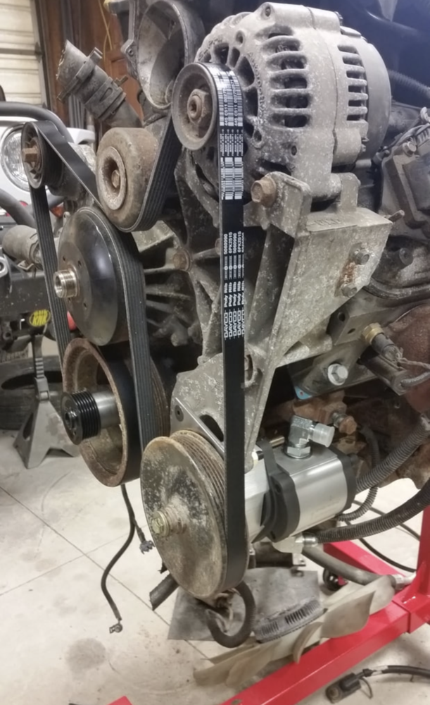

I was hopeful because the bracket I got was for the stock pump to be used and moved higher. This pic shows how Scott had it mounted on a stock bracket.
Not sure if the pump being deeper would interfere with something. Kinda like how it got into your coil pack. But mine would definitely be lower and I feel like it’s going to be too deep.

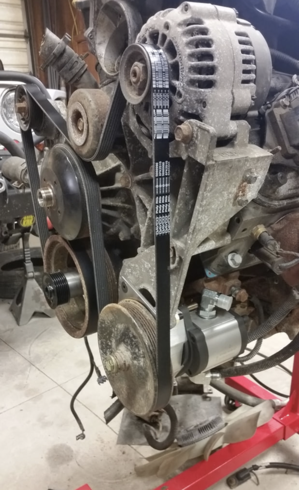

That picture looks like the pump and your upper link would want to occupy the same space.
Depends on your chassis and link layout. If your links are placed outside your main rails, then the low mount will work; but if they're inside, you'll need to ditch the stock acc bracket AND the GB unit. I assume you are on truck spacing, and assuming you cannot use the low mounting on stock acc bracket, I would relocate Alt. to passenger head, and use Scott's bracket on driver's head with coil relocation. The Scott's pump has suction...therefore it can withstand being equal height to the resi, or even a tad higher. You can use the PSC resi on a single steer application, but you want as big a feed line as possible- likely -12 from resi to pump. For instance on the shop buggy with dual steer, it was recommended that I use -16 suction, -8 feeds to valves, -10 returns from valves to filter housing, and -12 from filter to resi- but I'm dual steer with 3x9 rams- Scott recommended 1 gallon resi on mine...
