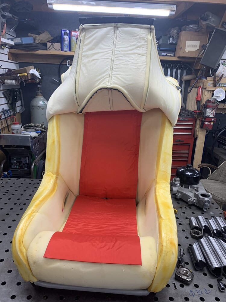

Just installed these in my Beard seats. Hog ring pliers were a little aggravating. My tip that worked for me was to also use a pair of vice grips to pinch the two rigid lines back together. It’s total hell on your finger tips otherwise. Once you’ve got the vice grips in place, it was no trouble to line up the jaws on my hog ring pliers and get a good bite on both pieces of material. Oh, and I didn’t waste my time with the double sided tape that came with the kit. Straight to Gorilla Glue spray adhesive.
