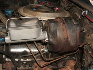

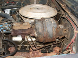

Decided to tackle the brakes last night. Hoping to find a pedal height adjustment common on early jeepsters, I laid under the dash for several hours. I didn't find the adj., but did find a bracket (happens to hang the pedal AND braces the firewall) with both tabs snapped off. Since it appeared to be adding major slop to the brakes, I spent about 2 hours getting it out, and fired up the Hobie for repairs.
A couple chunks of 3/16" stock were welded on the rear face (since I didn't want to change the spacing) and the tabs were gusseted to thwart future escapades pulling the SOB back out! Didn't feel like contorting any more, so I worked on slotting the '79 Marquis MC & setting the pushrod depth... got it bolted in place, and called it a night.
Tonight, I spent 45 minutes reinstalling the bracket, the WS wiper motor, guage cluster and all the other crap that had to be removed to get the bracket out to begin with. My son assisted with bleeding the MC and re-attaching the lines. Didn't have time to do more than move it a few feet, but WOW! the pedal feel & travel are improved about 300%.
Below is the Merc MC and OEM... If size and bore are any indication, it should be nice!

Oh, she'll stop now! Not exactly Cadillac like, but it'll bind her down much better than before with a lot less effort!
The MC/adapter/new fluid is the 2nd best $20 I've spent on her (1st best spent $20 was the used RS9000s! :flipoff2: )
