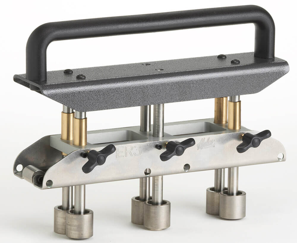

Roof metal for this and other small projects. Ideally was looking for something to roll the sharp edge.
My father in law uses one of these to turn up the edge of field cut panels on roofs. Works great
