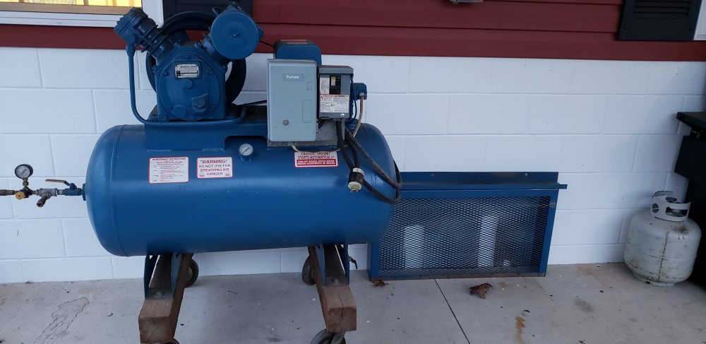

After well over a year of watching... this popped up in @tknopp backyardšŸ¤«

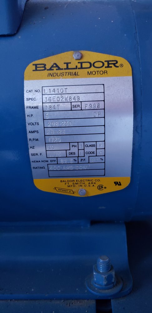

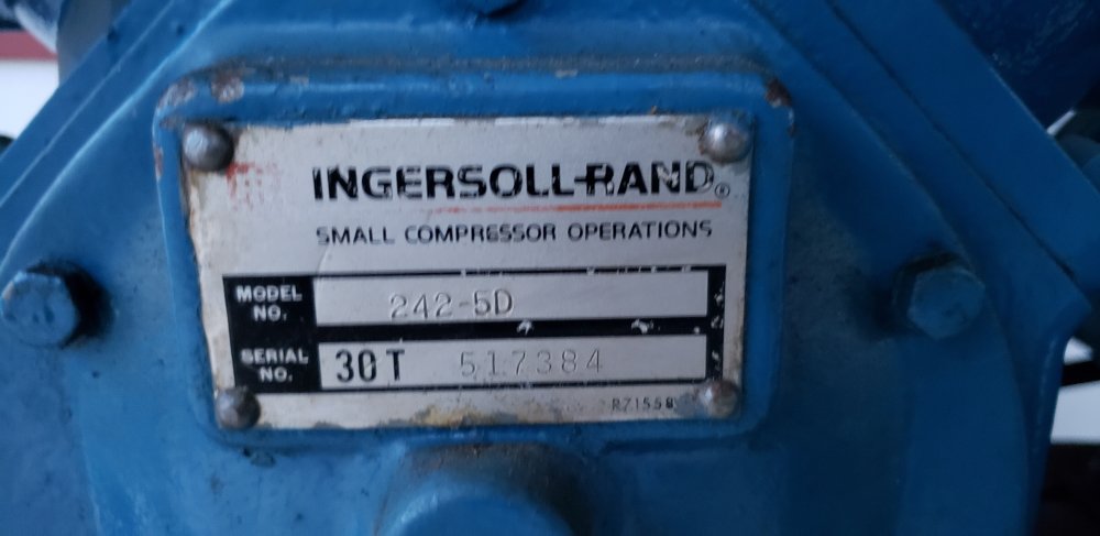

Circa 1993 (by tank date and the blue isn't exactly an IR trademark?) Ingersoll Rand 242-5D T(ype)30 pump with 5HP Baldor 220V single phase on a 60 gal horizontal carrier. Everything I can find say 15+ CFM and max pressure 175psi.
The last 22 years it lived inside a gentleman's shop prior to his passing (admire him... bought it to run finish nailer for installing molding in house, well thats what he told the wife šŸ¤£), "blowing up tires and moving sawdust around the floor" according to the wife.. Belt guard removed to fit under shelving where parked. The casters proved VERY handy for loading/unloading, so think they'll stay...
Will "clean it up" (<10 minute job), check pump oil level/inlet filter (for dirt daubers), remove the plug and wire it directly to my disconnect for testing. After that, it'll get oil changed, new filters, and be good to pass onto my heirs!

I dig it. But the ghetto caster blocks look like lift blocks on a front axle.
I'd have to fabricate something less.......something.
Agreed...
However, (despite the "looks") the 4x4's being wider that the receivers footprint added a LOT of stability and while I'm not planning to move it around once connected, the casters (urethane tread) are pretty nice!
May drop the cribbing on the concrete for stability (won't move) and recycle the casters for another "project" šŸ˜‰
