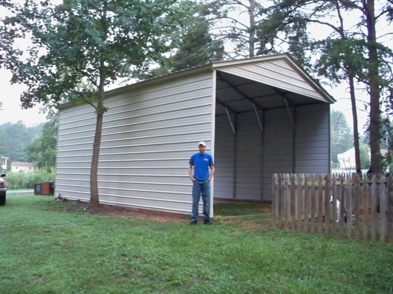

Bunce Buildings
I got my shop built by Bunce, Was nice, came home it was done.
Well Half of it. Cost $4,100 Like it sits in this pic. 20X30 with 12 ft walls. Now heres where they try to get ya.
20X30 12 ft walls finished gable ends $4,100
Heres how much they wanted to finish the ends
$900 per end (8ps) 3X20 Sandstone Sheet Metal =$1,800. WTF
$150 garage door frameout ( This option should have knocked down the sheet metal price seeing its pre cut, But no change in price.
$50 Walk in door frame out
$500 Roll Up Door (Cheap crappy door)
$150 Walk in door. ( Mobile Home door with diamond window, Do I at least get a free roll of tin foil?
Long Story short, I finished both ends myself for $1,000. A grand bought the Sheet Metal, Hardware, Studs, Garage door.

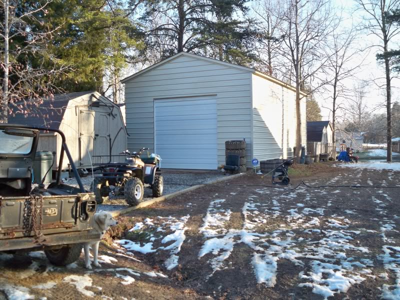

Finished product, Sorry its a mess, its a SHOP
Finished product Around $5,100. Good thing was I already had a 20X20 Concrete Pad. Call Bunce. American Steel, whoever there all the same.:beer:
