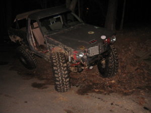

finally got motivated and put the tires on the runner like I've been threating to do for some time now. Need some more trimming and to swap the chromy birf eliminator into it this week but it will be ready for harlan's ride this weekend. Who all going?

not the fenders they are gone :flipoff2: the firewall needs some more trimming, can tell you've never over tired a yota before...I've actually cut 3 inches out of the bottom of the firewall back to the cab mount and still need to trim the cab mount and move the axle another inch, the TG springs moved it fwd an inch already, wish I had more time and I link it an be done with it.
Yeah I want a set of 30 spline longs but the old longs I've got are starting to expand and won't survive that long with these tires and I sent the 4340 shafts out for cyro treatment and the super joints work great. I got a good deal on them what can I say. Even with my LC eng upgrades I don't think they'll break them this trip. Hell the weak link now is the 5.29 gears. I've got a set of 4.7 total spline gears that have been cyro'd in the crawl box and a 23 spline rear case with chromy 23 spline input and longfield's rear output. The dshafts are 2.5 inch .250 wall DOM so yeah since I've broke a set or two of 5.29's I'm guessing they will bust first. Either way I'm gonna have fun
