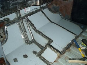

I just finished this one up. It is in a '53 willys wagon and also includes new floors. The shifters will be cut through once the drivetrain is reinstalled. Planning on just attaching boots for the tcase and then screwing a cable shifter for the tranny to the top. After everything is rhino lined.:huggy:
This is made from left over sheet metal thanks to a ricer running into an outdoor cabinet so it is heavier than I would pay for. I think something like 12 or 14 gauge. I would pay for 16 gauge if I didn't get all this heavy stuff for free.
