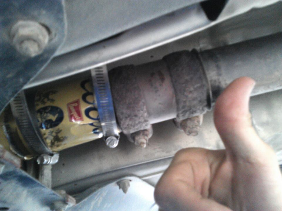

I have used the thing that @drkelly posted with absolutely no issues.
I've been accustomed to these on Big Rigs, but the last exhaust system I had built for my CJ, used these. Shop had Orilly's drop them off. I've re-adjusted my muffler, & these are a Breeze to use. And No leaks!
I took a 5" one I got from work, cut it down to be a 3" version, and used it to hold the tailpipe in the muffler of my Ram for about 3-5 yrs. It was still working until the inlet to the muffler finally rusted out and I replaced the whole thing with an MBRP system.
