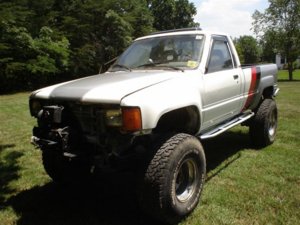

Before

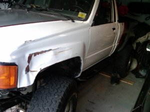

After the tree modification heh...hurt my dads feelings more than mine!
And yeah, won't be long before we knock it all out smooth again and repaint for the heck of it.
