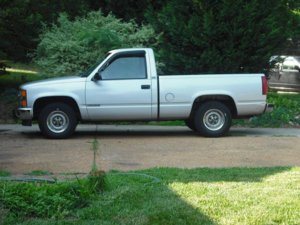

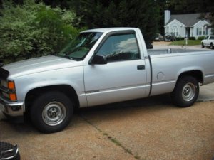

SLow Rider is my new DD truck. While its not the typical econo box I will be playing with it as I work to get the MPG up. Shooting for 20+. I'll be getting a baseline this week as a starting point. Though the EGR isn't working so that will affect the numbers..
Anyway here are the specs.
1995 C1500 (1/2 ton) Short Cab Short Bed, 4.3L V6, 5 speed NV3500, 8.5" Rear w/3.08s rolling on dry rotted 235/75R15s
Was painted 3 years ago so it looks pretty good.
Overall its mechanically sound, and has been well taken care of, but previous owner always had a shop work on it, so a lot of little details are lacking. The normal TLC you put into something when its yours.
I was expecting to have to re-gear it but got lucky and it has the perfect 3.08s I would have wanted anyway.. It chugs along at 60mph pulling 1600 rpm. Its not a rocket ship but it pulls it ok.
So far the maintenance/fix list is: New tires. Fix the broken/needed items and any small things taken care of so its reliable. So far the list is, Radiator/Hoses, belt, water pump, idlers, ERG valve, O2 sensor and temp sensor. Not all these parts are broken but over the years I've learned that most of these are subject to failing with higher mileage. The low cost of these items makes it a no brainer to just change em now, especially with the radiator out and block drained.
DROP IT ! - After the maintenance stuff I will be lowing the truck. Pretty sure I'm settled on a 4/6 drop.. Its actually got a 2" shackle drop (leveling kit) on it now but I want to make it lower. This I hope will help with the MPGs though I know probably wont recoup the price of the parts it will make it more fun to drive everyday.
Interior - I will be looking for some buckets to replace the bench seat. And installing some cheep as radio to listen to some tunes..
Tuning - Its a 95 w/ the good 7274 PCM so I can have some fun tuning the computer a little. Nothing major just looking to tweak as much MPG out of it as possible. Plus there is some lean burn mods I plan to do that I've read is good for ~2mpg but you need a wide band O2 to fully monitor it. So this will be a more longer term thing..
Anyway some pics..

I had basically the same truck but in longbed when I got in the parts buisness.Good reliable transportation.They are gettin hard to find that are'nt eat up w miles.
I had one w/ a belltech 4 and 6 drop years ago. Mine was a 95 also but had the 350 in it. The ideas are endless on this particular truck and the most cost effective for parts and mods I've ever owned. Looks like you got a pretty straight one. VERY GOOD CHOICE.
Also need to french the plate into the tailgate. :beer:
Ya the overall reliability, cheep cost of parts both new and used and easy of work/maintenance on these trucks are why I settled on it.
I dono what look I'm going for, but it will be functional so, ill probably keep the plate on the bumper :)
