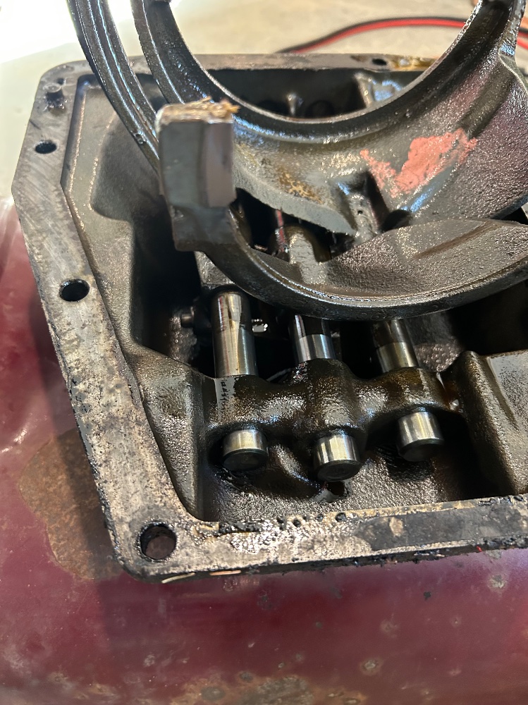

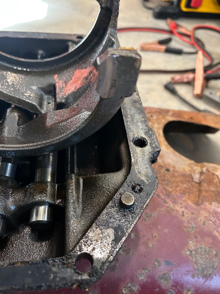

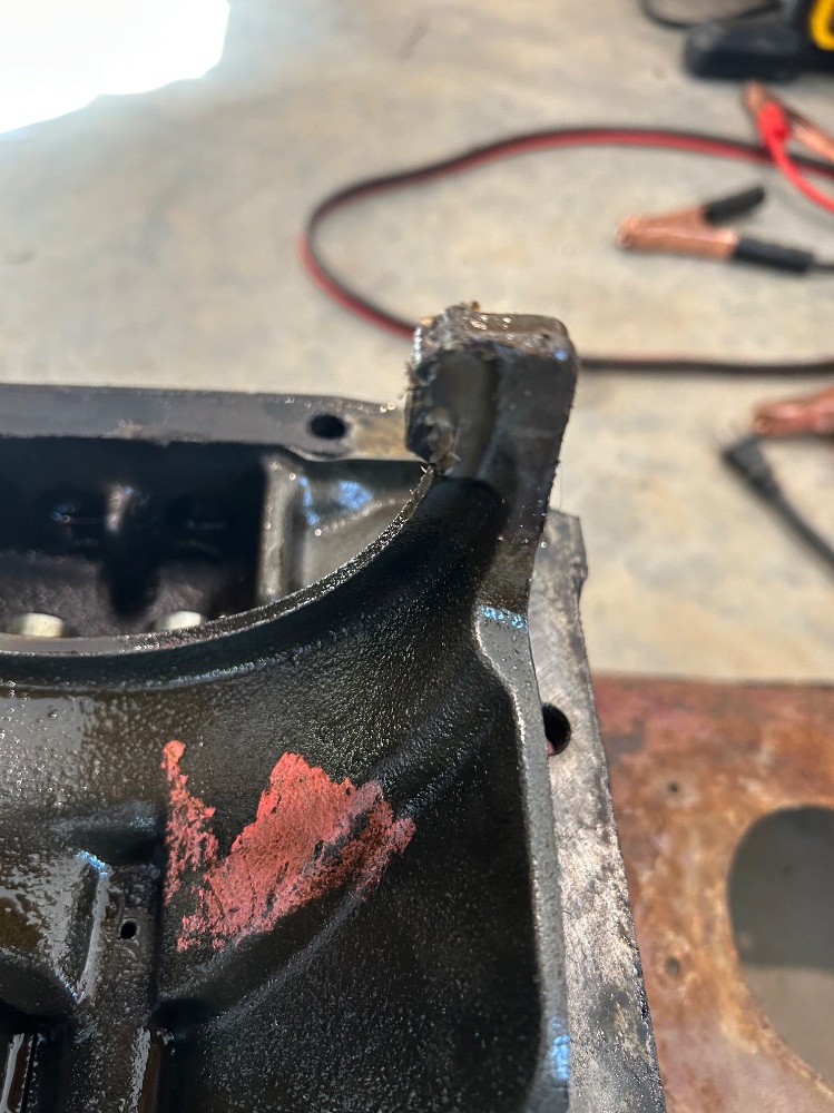

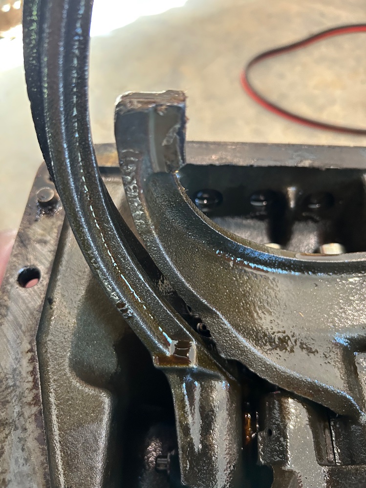

Trying to get the k10 I picked up sorted out and the biggest issue is the transmission pops out of third gear when accelerating. I pulled the cover just to see what it looked like inside. Third gear can see some visible wear as expected. The coatings on the shift forks also look pretty worn…although 1-2 looks way more worn than 3-4. I haven’t pulled the top case apart to check out the detent springs. What are the odds it’s just forks and sorings vs pulling out synchros and gears? Any 4 speed gurus on here? @Shreddinlettuce

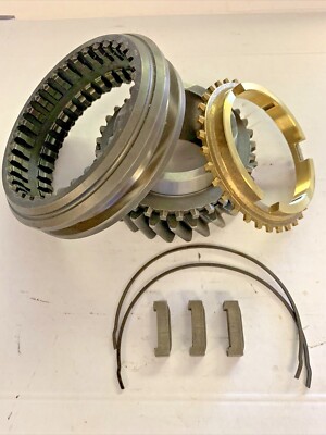

from Novak website
SM465 3rd Gear & Slider Update Kit (TorqueLock/Anti-Jump-Out)
The SM465 is pretty close to perfect in its design, but this update to 3rd gear and its slider are considered to be essential. The tapered clutch design prevents 3rd gear from kicking out under torque.
