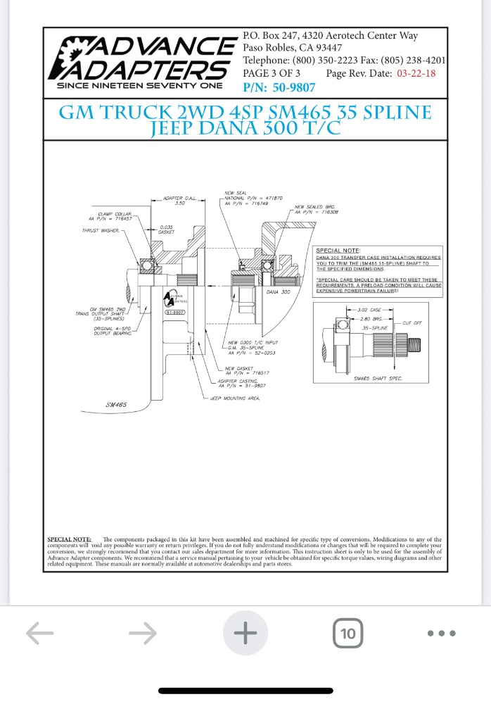

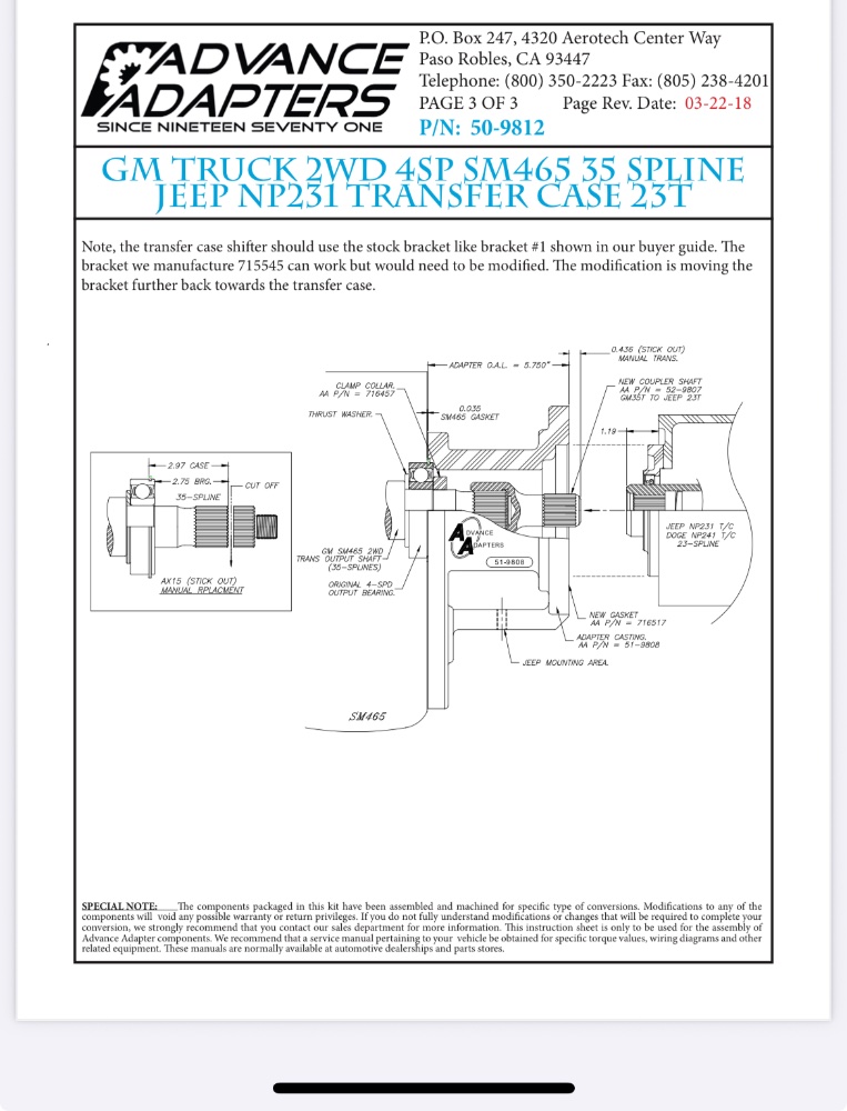

I have one in hickory, it’s a 2wd iron top, can be adapted to 4wd with advanced or Novak stuffs
Thanks for the offer...going to try and find something plug and play first. Wisdom says just buy the 3rd gear upgrade you posted and rebuild, but I don't want to wait the 3 years it would take me to do it :shaking:
