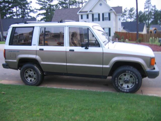

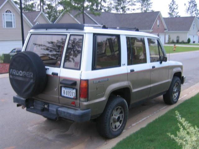

So I found this Isuzu Trooper...
88 was somewhat of a bastard year for troopers... it was basically one big changover year for alot of stuff from 87 to 89. so, it really depends on the build date for exactly how many 87 parts it has or how many 89 parts. the major thing to look out for is the differentials. some had the older 10 bolt rear/8 bolt front. you want to newer 12 bolt rear/10 bolt front. it will be a fi 2.6 motor. typically, most 88's had the poor head castings. even if you do crack it, there's an aftermarket casting for ~500 bucks that is top quality and you'll never had a problem with. swapping a head on them isn't too terrible. looks like it's an ls, which is the nicer interior package (including the fully fold out rear seat that's kick ass for camping). really, you can't beat it for 800 bucks. they're basically bulletproof in stock trim except for the head issue.

When i was a little younger, my parents had the ugliest 1988 I have ever seen, but it went where you told it and never complained. The one you have in the pic is nice looking. just my .02
