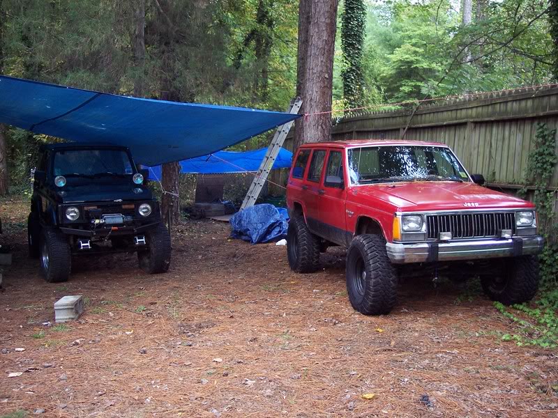

Here's some rigs iv'e built/had a hand in this past semester when I probably should have been studyin for class . . .
85 Chevy k5:
44chromo'd/14bolt welded
6" leafs front/shackle flip dropshackles rear 3" body
Fuel Injected 350/700r4/208
moved the gas tank to the bed for clearance
made new fender lines w/ the angle grinder
44x18.5 Gumbo's on 18 bolt beadlocks
Made Front/rear bumpers and rocksliders

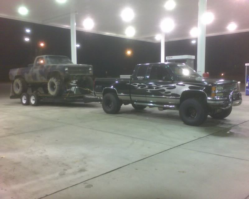

K30 military truck:
Helped Jason when he cracked his frame to plate it and put the hydro assist on, my truck was having a real fun time towing his big heavy rig
Sammi:
He blew his old motor so we swapped a 1.6 side kick motor in
87 K10
6" susp lift
35" mickey T's
40" Gumbo's
TJ
swapped in waggy 44's and trilink rear/long arm front RE lift (still in progress)
XJ
Rockkrawler 3 link front
