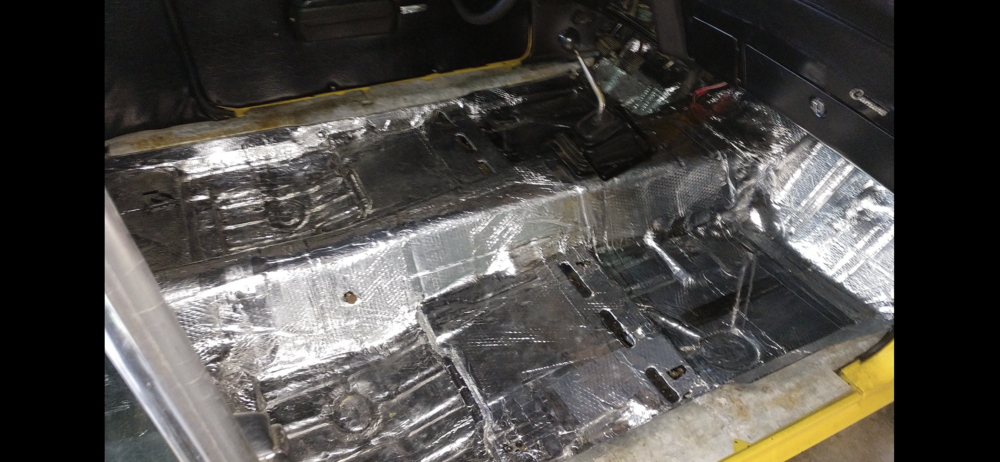

I used Noico 80 Mil sound deadener from Amazon on my Camaro. It’s pretty similar to Dynamat but much cheaper. It made a huge difference.

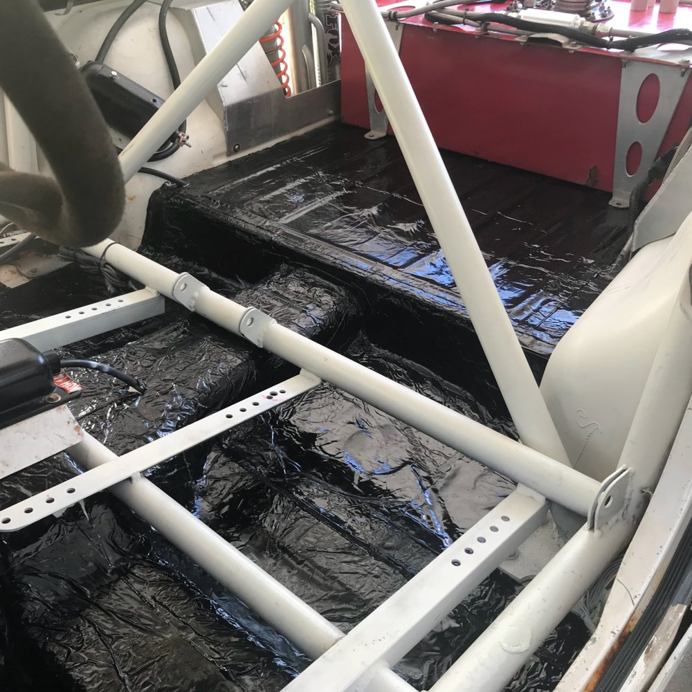

@UJO told me the budget competition sound guys used Grace "Snow & Ice". I couldn't find it locally, so used "Peel & Seal" (black tar shat with aluminum top layer). I used it to do my old Foxbody Mustang with very good results... took a lot of rattles & resonance out and made the whole thing "sturdier" sounding.

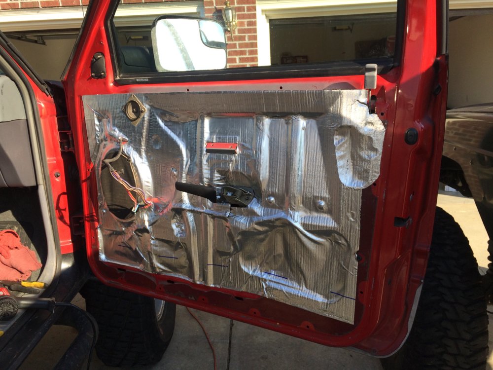

I used something similar to that in my old 2nd Gen. Cummings and it did pretty good. I may have some old pictures from back then. Used an electric heat gun and roller. Definitely “sealed” up the cab a lot! Did the doors, full floor pan up as far into the foot well as I could and 2 layers against the back of the cab and around the sides of the extended cab area. I bought it at ABC Building Supply.
