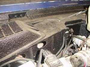

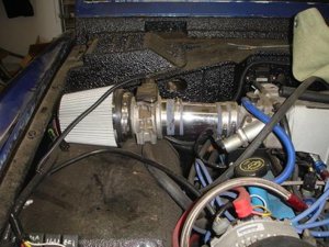

Not true, Herculiner sprays excellent! You need a shutz gun to spray it. I used a gun made by SEM for their bedliner and it worked great. If I didnt already have the hurculiner I woulda used the SEM because it seems to be a better product and is tintable. Shoot it at about 65 psi for best results. Heres a few pics of my sprayed in herculiner underhood. SB
Forgot to mention, there is a UV topcoat for herculiner that keeps it from fading. Even LineX fades BTW
