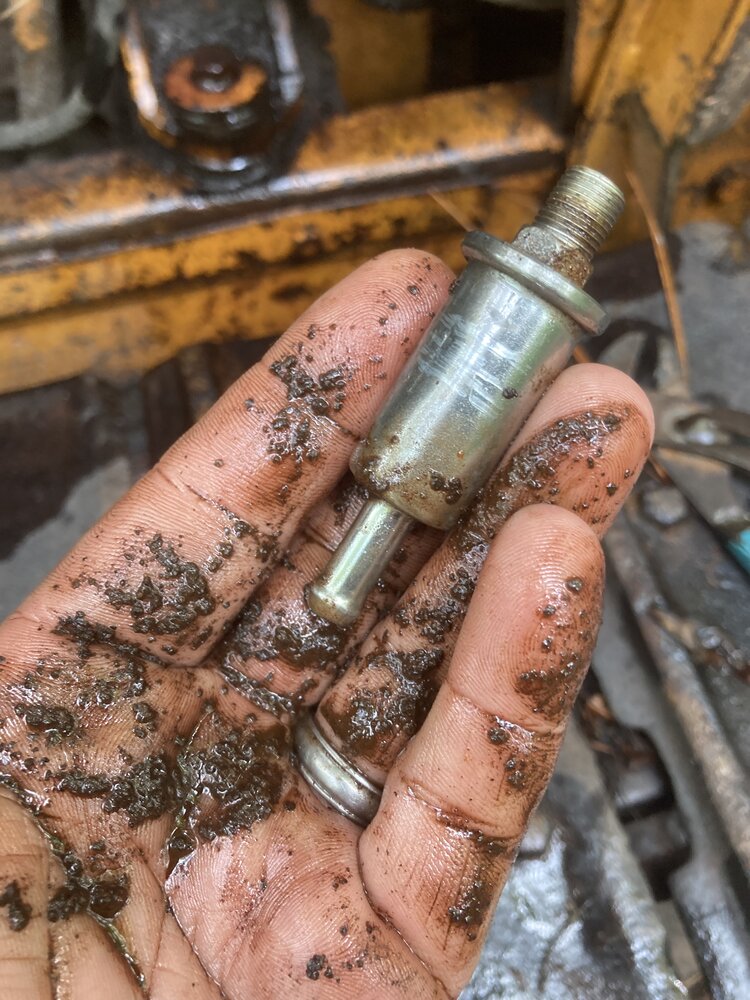

After replacing both of the large napa fuel filters I was still having issues. Found this inline edelbrock filter tucked up under the seat and well, you can see the outcome when I pulled it.
$12 for a new one and it’s been running well for the last 2 hours. Probably a lot of trash in the tank, so I suspect this filter will continue to give me a fit for a while until I run a few tanks of fuel through it (and probably several filters) and hopefully flush most of it out.
