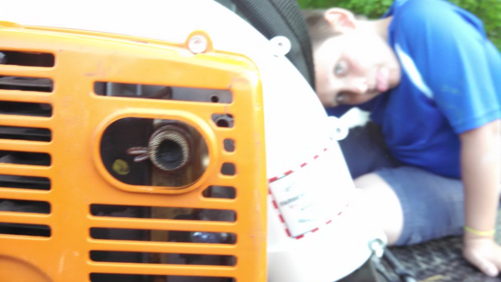

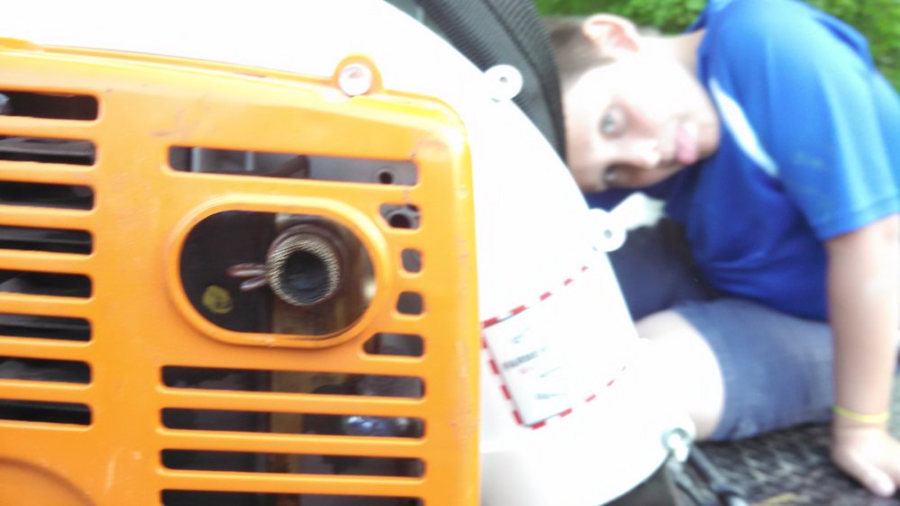

Pull your exhaust I have a hunch it's stopped up. They have a screen that cakes up with crap.. very common with the br380. They also have an external "spark arrestor" that you can do away with, they cake up with gunk as well
Bingo! I just pulled the arrestor, runs like a champ. Thanks Clayton!
