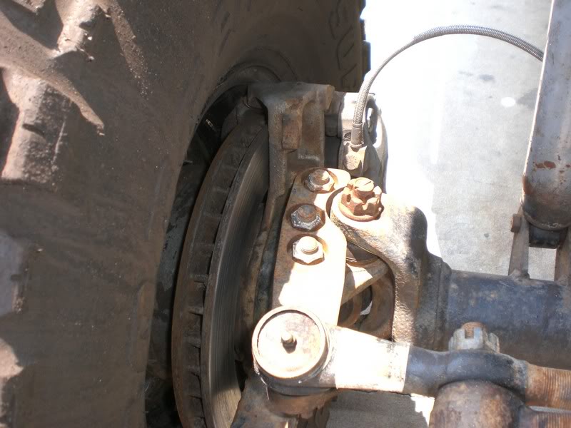

found my problem...
somehow the brake caliper bracket itself has bent... into the rotor..... ugh
