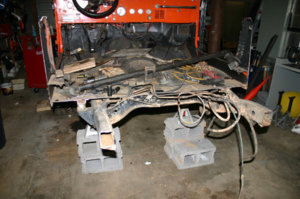

Before:
http://www.nc4x4.com/forums/attachment.php?attachmentid=2291&stc=1&d=1137534337

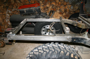

cut rear frame:
http://www.nc4x4.com/forums/attachment.php?attachmentid=2292&stc=1&d=1137534337

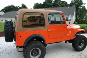

adding new frame, bracing, crossmember:
http://www.nc4x4.com/forums/attachment.php?attachmentid=2293&stc=1&d=1137534337
