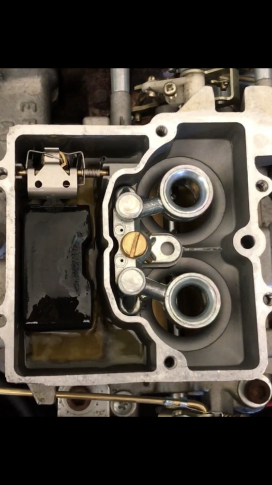

Looking at the fuel bowl itself I don’t quite understand how it’s still happening, especially with the vents raised so much.
Front of the vehicle is to the left.
This is a screen shot from a video, top of the float is wet from me messing with it.
I had to back the float level down on my old 2100 farther than the interwebs recommended.
At "spec" level, it would flood taking a hard turn off an exit or slamming the brakes.
Just kept lowering it until that stopped and it would stay running everywhere else.

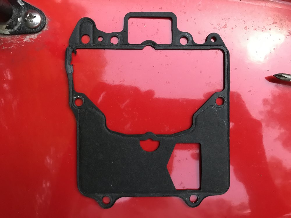

Another thought, does the gasket you're using cover the bowl entirely?
I'll keep fiddling with the float. Before I was worried it was too low and uncovering the jets.
I'm using this style gasket. You can see the drivers side vent is a near direct shot to the bowl. I believe that's why that one is typically capped.
