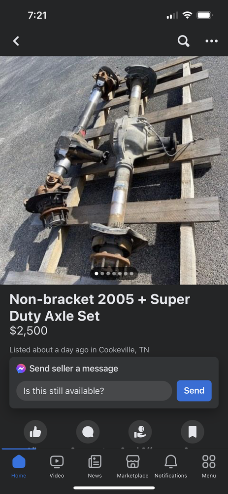

Given what I see axles of FB selling for, Id bet he could sell cleaned SD60s for $800-1000. Which should land him in the 300+ range for this time to clean them.
That could be the real kicker. If he hits up the JY's or whatever and has axles sitting in his garage/shop ready to be picked up that have ALL the crap removed ready for trusses and link brackets, then it would be worth even more to me.

That’s the plan. Already have a stock of them. Biggest issue is I need to get on Fb to really market them
