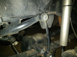

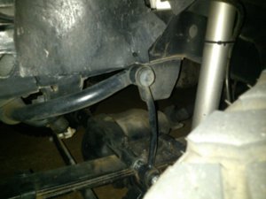

I got these quick disconnects and they are a little longer then the ones on now. So my question is what is going to happen if the angle is over 10degrees up?
10 degrees won't make much difference. Flatter is better, but you are probably fine up to about 25-30 degrees, and even then it will just translate as a stiffer swaybar
Are you talking about the sway bar itself or the links?
