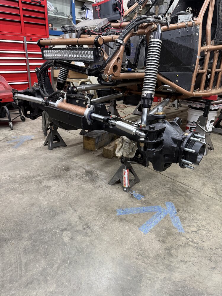

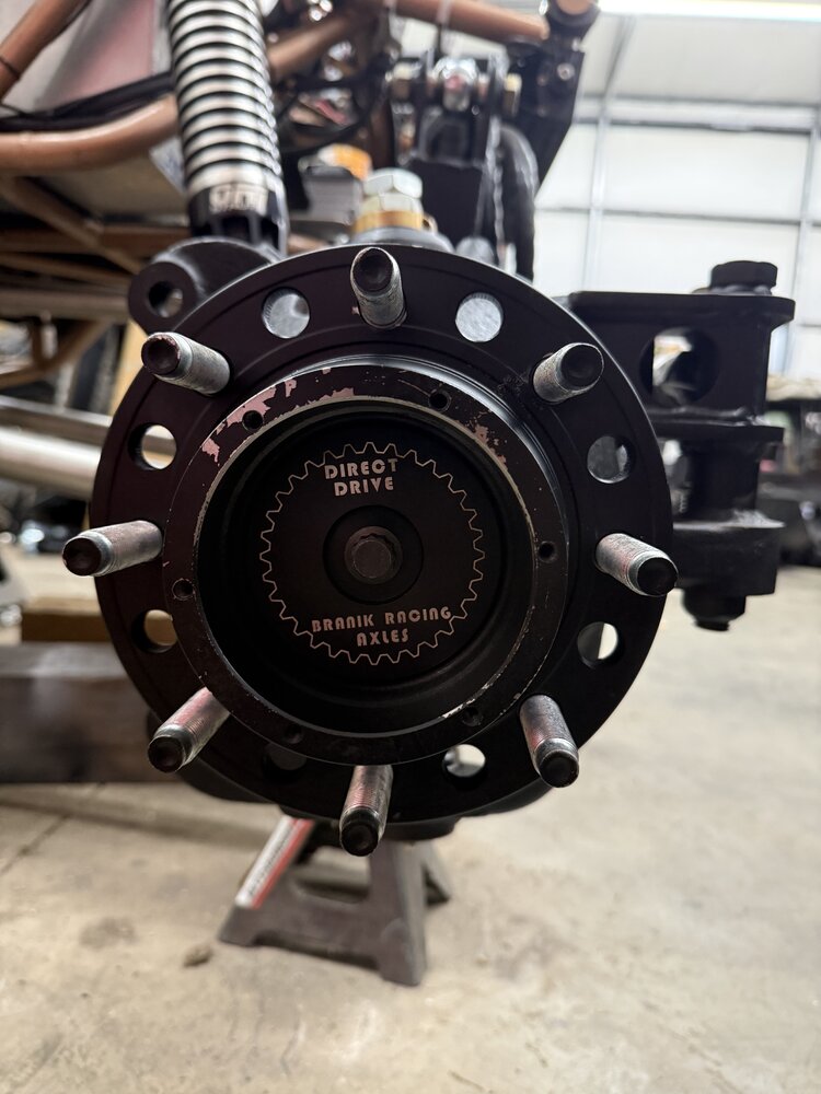

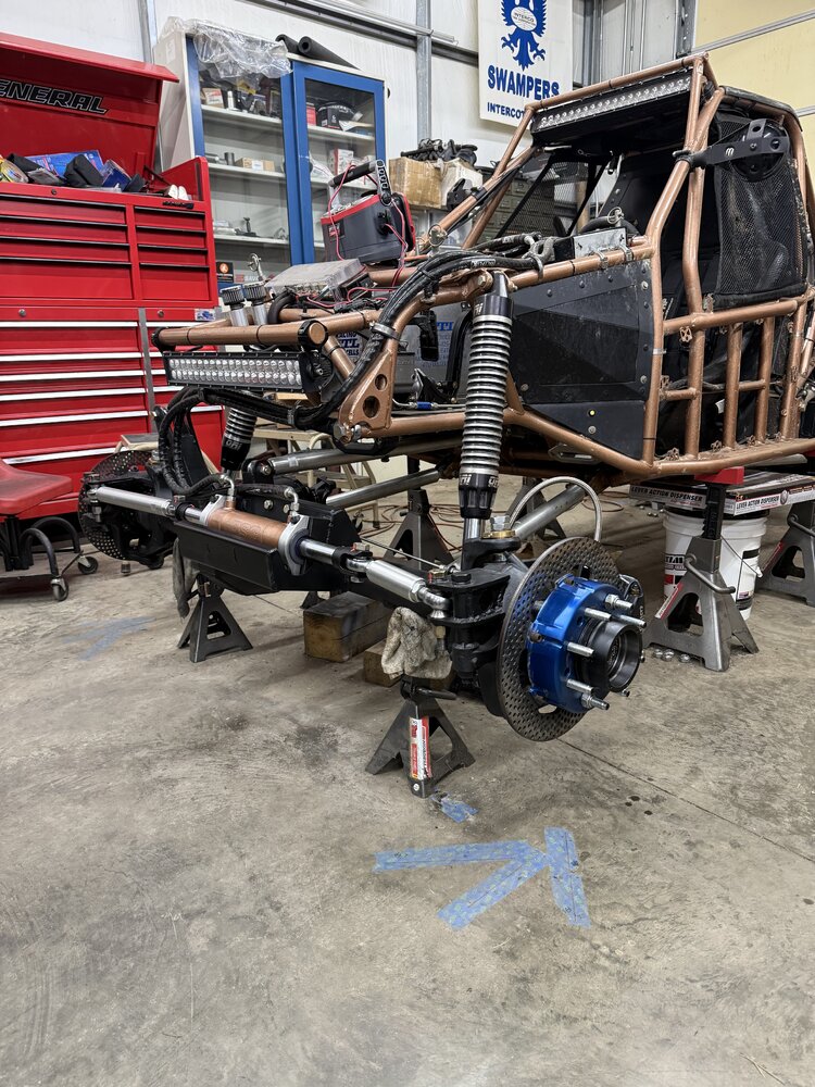

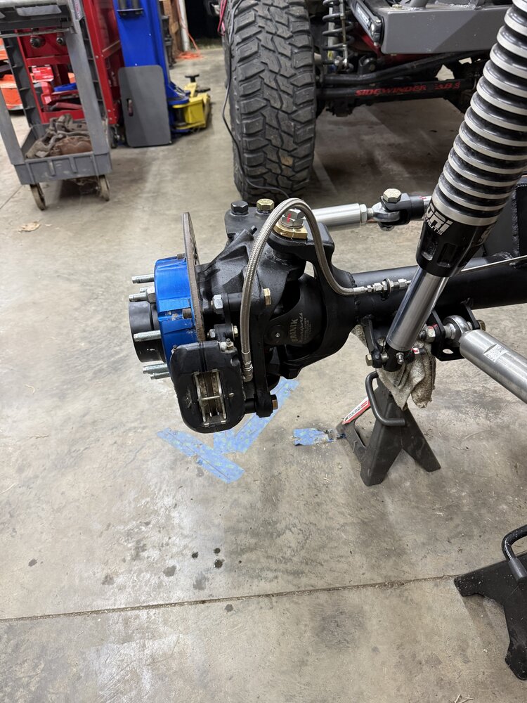

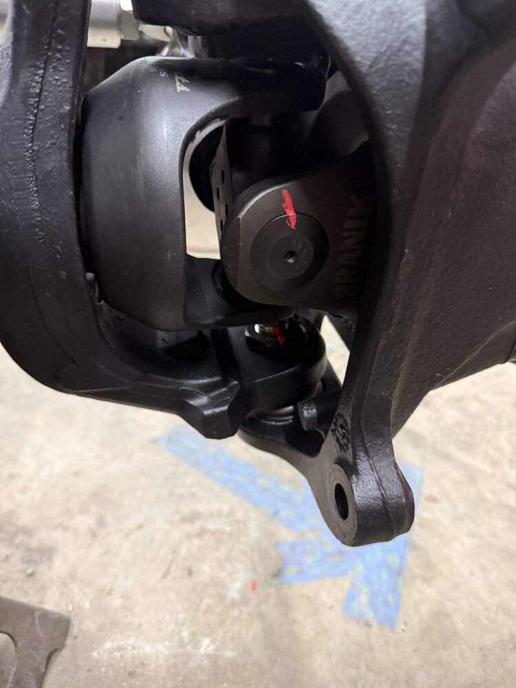

Got the shafts and hubs installed this morning. Need to grease the joints and install and bleed the brakes.
Reason I ask is because I had a couple of my CTM caps walk so I started tacking them. I've read others having the same issue. 👍
I’ve definitely heard those stories too. I had planned to do the loctite bearing retainer compound on the caps. I forgot it when I assembled them. So I asked Lee if I should and he said he’s never had any issues with them.
I got the brakes bolted up yesterday morning.

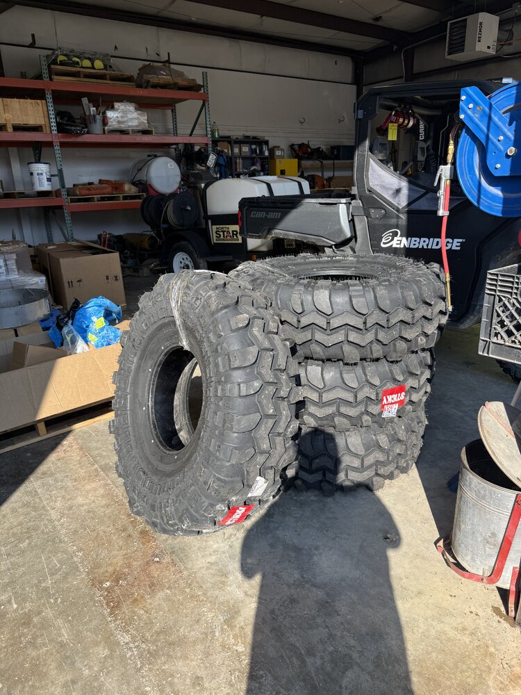

My old Stazworks wheels don’t fit over the ‘05+ hubs. The center bore needs to be opened up about .030”. We’re on the way to the beach right now so I’ll take them to get machined when we get back next week.
The 39” Reds sold yesterday too so I’ll be ordering some 43s when we get back as well.
