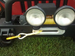

I need to unspool my line, and grind the opening on my bumper on the bottom as my line makes contact on the bottom before it contacts the fairlead.
I know this is a little old, just randomly came across it...
... but instead of messing w/ the hole you made, there are some hawse-style fairleads that have the holes offset so they sit "down" a little farther (so not centered top/bottom). You could just use one of those flipped over, no need to grind your hole.
I actually have one, PM me if you want it.
