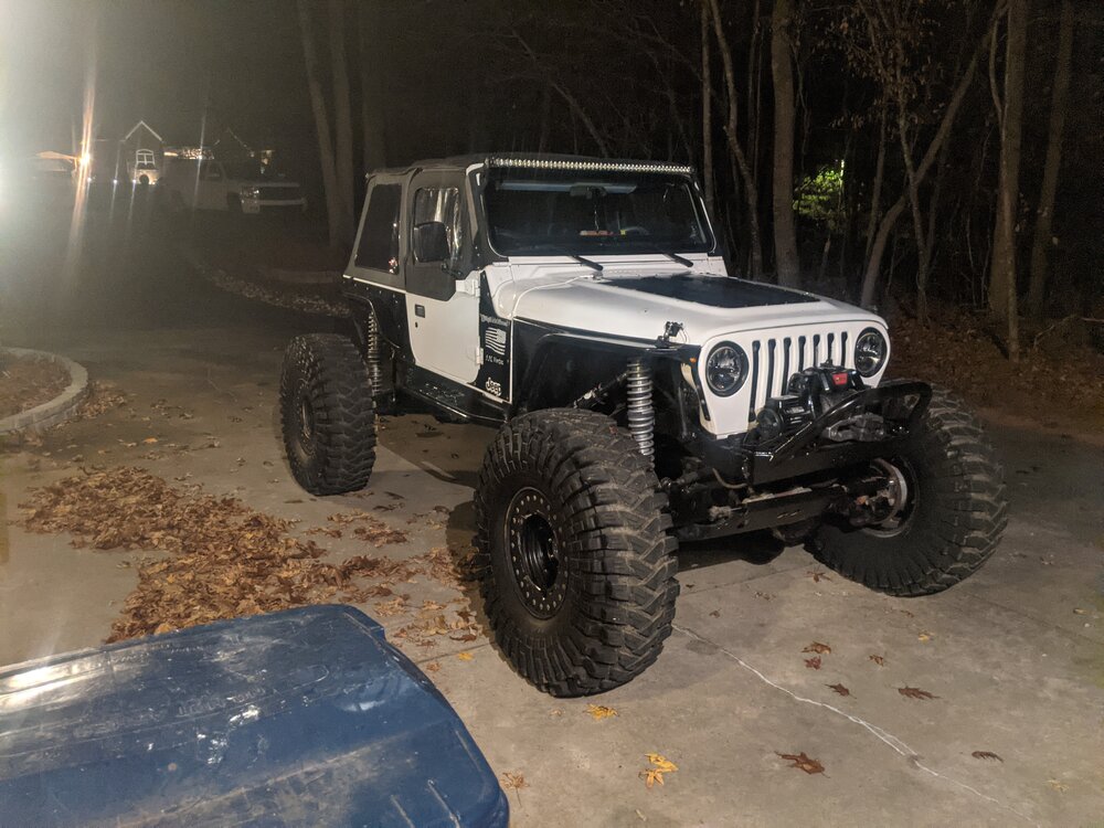

My neighbor did this exact thing about 3 years ago, all by himself, and he had never even owned a jeep before. What are you waiting on?
Of course he had been a professional fabricator for nearly 30 years, ran his own auto repair shop for 20 years, raced and built drag cars his entire life, and swapped v8's in many things before including jeeps, has 3 lifts, and every tool imaginable. But he had never owned a jeep before. :laughing:

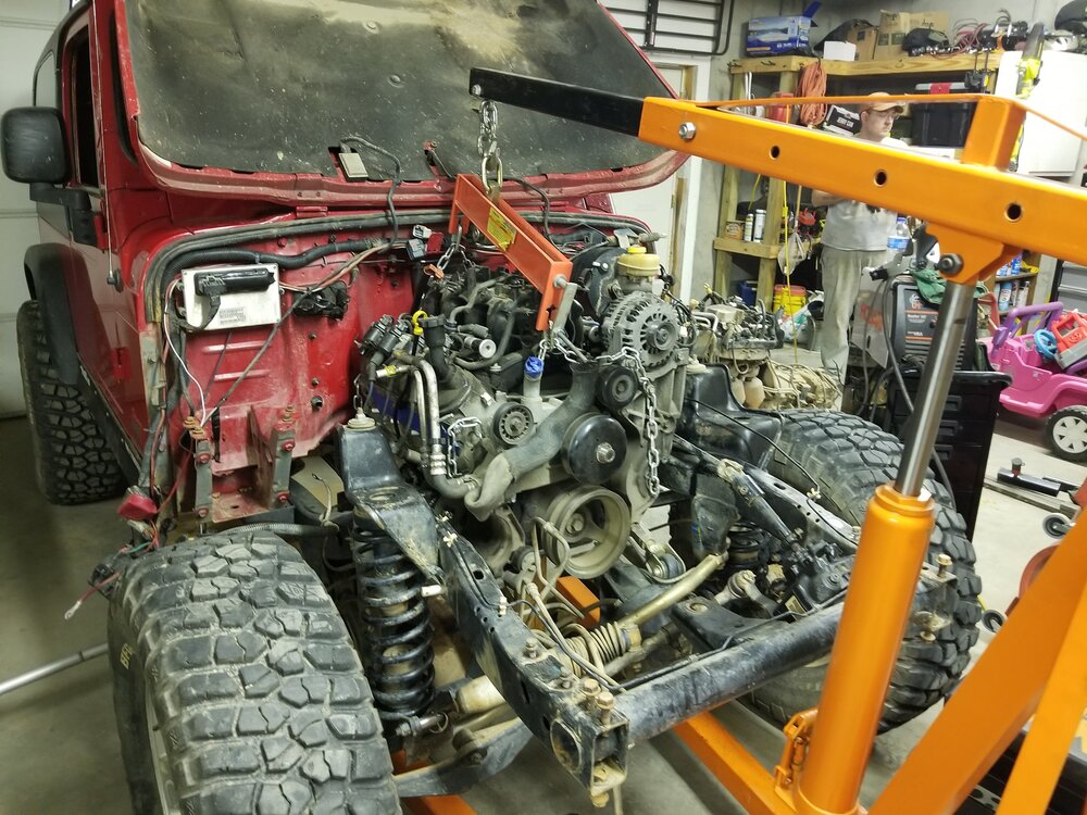

I've done 7 now, mostly Gen5, 2 gen3, and a gen 4, coyote swap etc..you can call me probably easier to chat or tonight I can type out details.
So to be perfectly honest, the big stuff is easy peasy and it's all been done before. It's the details and small things that take time.
Buy a set of motor mounts (I used Dave's), buy or get someone to cut down a harness, and you can have it in and fired in a weekend. It's the plumbing and wiring and AC and and and that sucks. I have a little over 5k miles on my swap and I still don't have reverse lights, cruise control, and I need to rework some of the engine harness fuse block. But I love it and would do it again.
