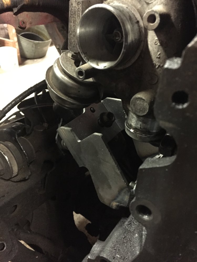

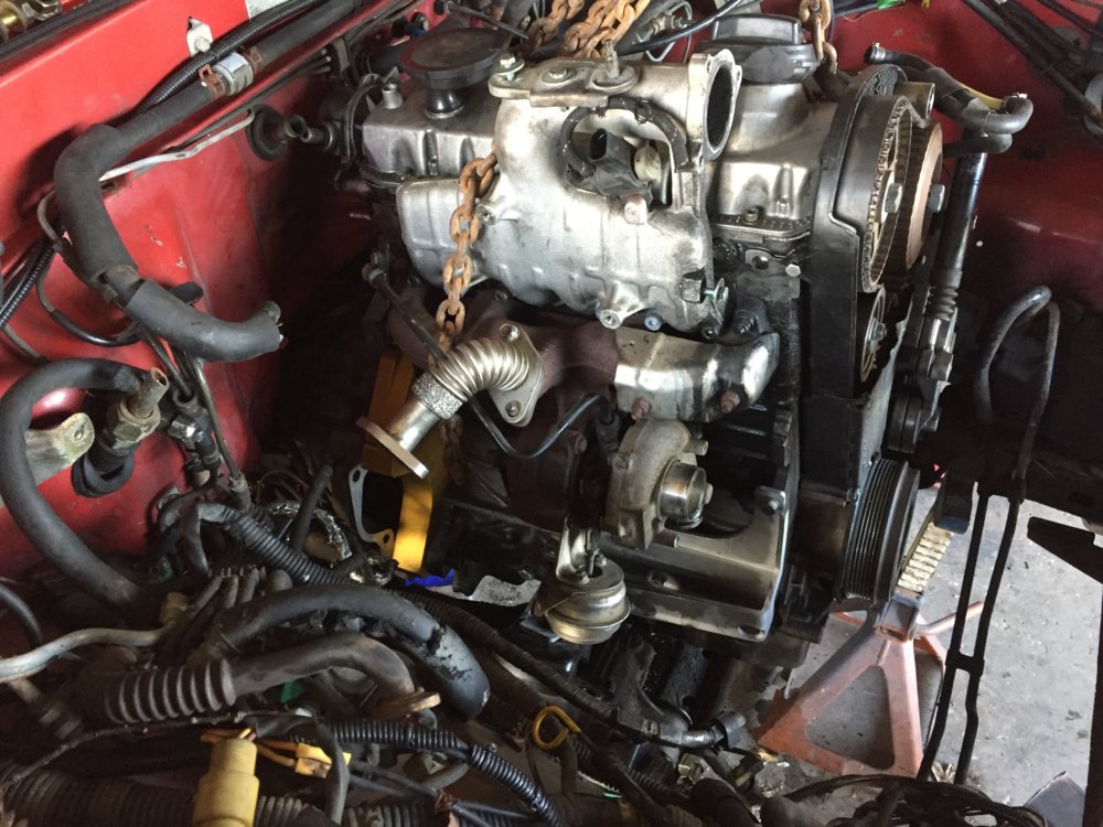

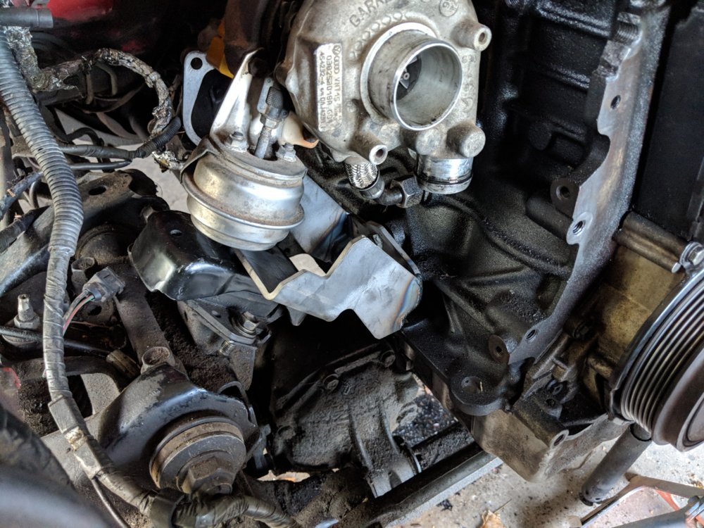

First test fit!

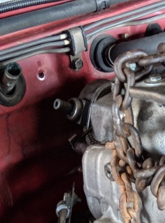

Looks really close to the firewall, is there space to get around it if needed?
How does the front-back length compare to the 22r(e)?
I guess I should’ve taken a better pic. This setup has all kinds of room between the vacuum pump and firewall. In the pic, it looks to have interference between the pump and heater core. In reality, there’s a mile between them!
As for being able to get around the back of the engine, I can easily install the bellhousing bolts and tighten them from the top!
Comparing to the 22r, the TDI has much more clearance around the back and I’m guessing it’ll have several more inches between the engine and cooling fan. The TDI is a few inches shorter.

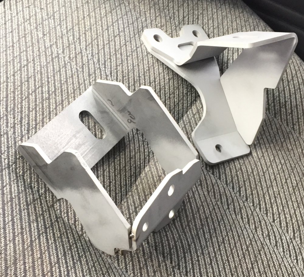

@Ibayne
I’m thinking $800 without anodizing, $900 with anodizing. If you both want anodizing, I’d split the cost between you.
If you wanted to make your own engine mounts, I’d subtract $100. I could supply you with the brackets that bolt to engine side and you can make your mounts from them.
I haven’t looked into doing a 22r yet so I’d have to CMM the backside of an engine. Another option would be to source a v6 transmission (r150) and use it or use the v6 bellhousing on an r151.

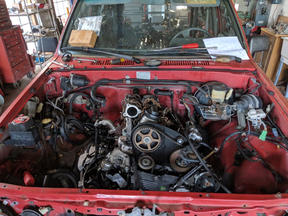

I’m not having much luck with making the Tdi conversion fit into a stock height IFS pickup. It looks like you’ll need to drop the front diff at least 3”. A SAS Truck would be fine at nearly any height.
that's unfortunate, but not surprising. With the way that front crossmember and pumpkin is designed there's just not a lot of vertical room.
What about realigning the mounts so it sits high and you add a hood scoop?
Gaining 3" on that diff is a challenge.
For me, adding a hood scoop isn’t an option because I just don’t like the look. Adjusting the mounts would be no problem and would be very beneficial if you were going for a flat belly but, like you recommended, you’d have to have a scoop or body lift. Dropping the front diff 2” and modifying the oil pan is another option. I don’t plan on doing this either because I’ll probably just go SAS.
It’d slide right in with no further modifications if you have an IFS Truck with a lift that has at least a 3” drop in the front.
