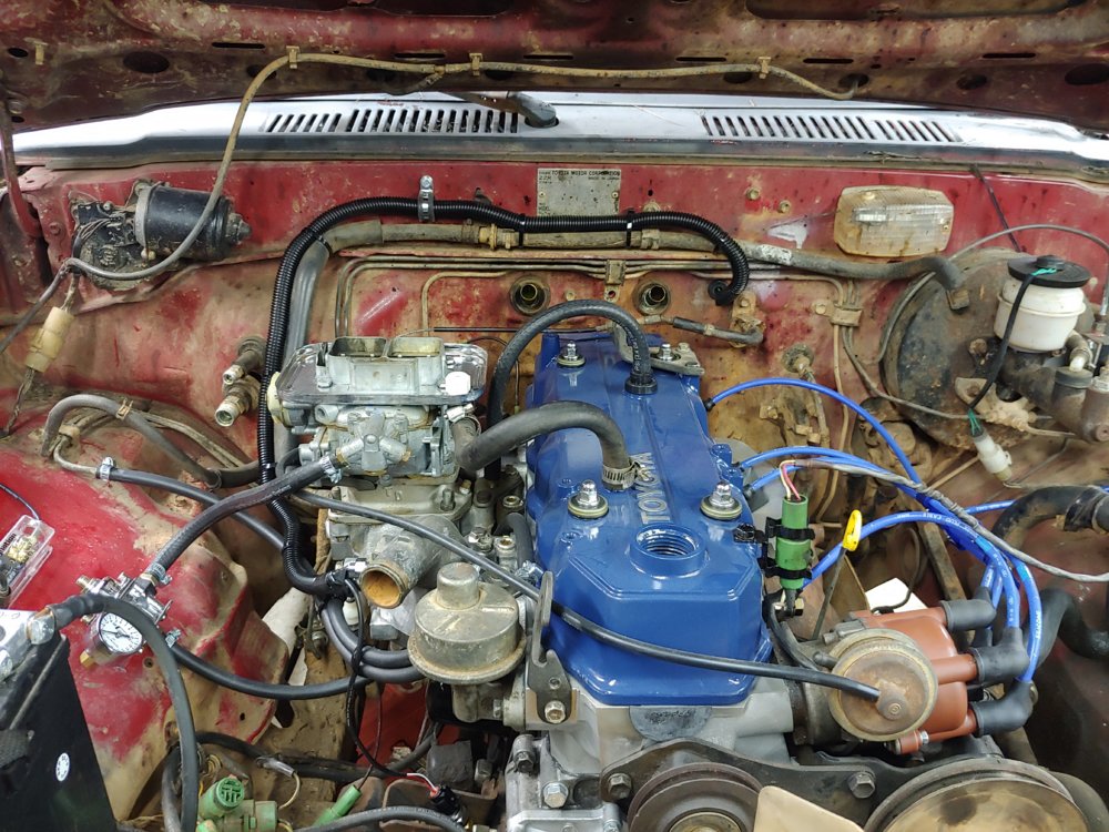

Come on over. Lol

I like to fold the end of the (un-stripped) wire over about 3/8 to 1/2 inch, and then put a piece of heat shrink over the doubled portion. It looks tidy, the heat shrink won't slide off, and it's easy to tell a capped wire apart from a spliced wire that's broken at the splice. I mostly use that method for small gauge wires and signal wires.
That looks nice and uniform to me.
