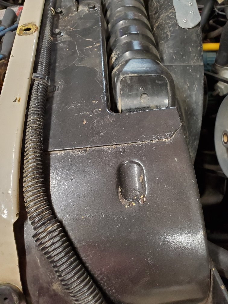

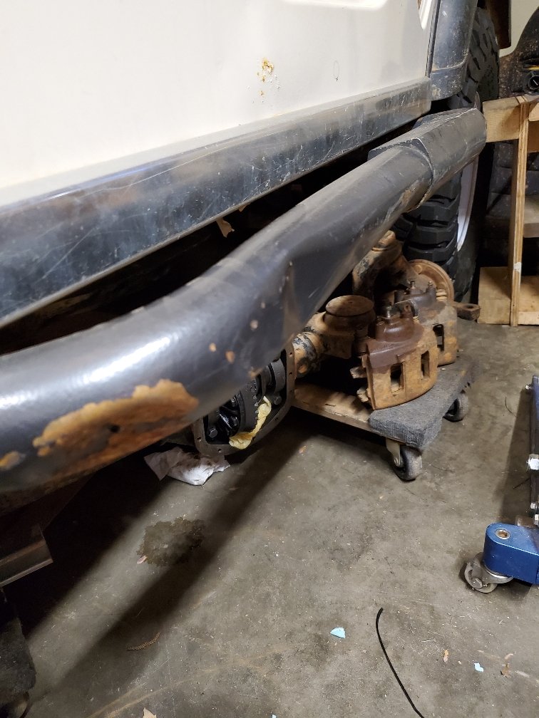

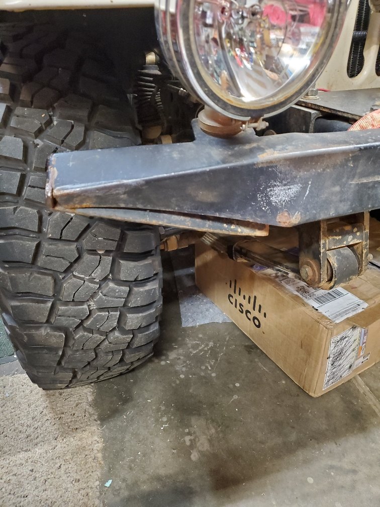

I used Rustoleum Hammer coat years ago. to paint underbody and engine compartment. It has held up well (for paint) but rocks will tear up any paint. Bed liner material I think would hold up better. Rustoleum sorta hides the imperfections but you can see them with the high gloss. I'll try and take a pic tonight if I remember.
Picture of my nerf bar with rustoleum hammer coat and engine bay. Plus front bumper with rustoleum, cant specifically remember the finish but it was a flat texture. Paint holds up well I think. Only thing is prolonged exposure to fuel, as with any paint it bubles.
Thanks. I use the same stuff on pretty much everything, its great for bumpers and sliders etc bc you can just spray more on later.
It does take a little experience to get good and getti g the coating/texture right, bc if you apply too much or too little it really affects the texture density later.
Bumper was rattle can and engine bay was with spray gun. Friend painted the engine bay, but the rattle can does just as well i think, and you can touch it up. Never have though.

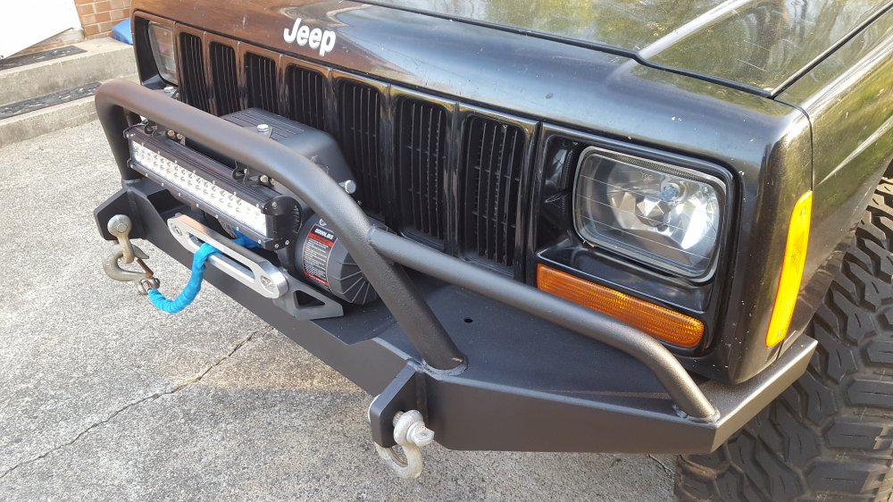

I used the dupli color bedliner spray on my old XJ winch bumper and sliders. Held up very well and the texture was not as course as some of the other spray on liner but had more than the hammered stuff. I’ll try and find some pics if you’d like
