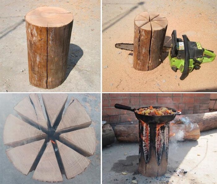

long enough to make bacon and then some

I didn't, just something I found somewhere else and would like to try .
It does look rather efficient, most of the cooking should be done by the time it becomes unstable.
My neighbor was just telling me about these the other day. He had a name for them... Norwegian Candle or something like that.
Close, It's a Handmade Russian Stove.
Cut it like the pict above shows and cram newspaper as far down as you can get it. leave a piece of the newspaper sticking out the side to light.
Oh and don't use Pine. use a hardwood. :D
my buddy sent me a youtube video of that the other day, it was called a swedish stove. they're cool, i'll have to try it out on my next camping trip
I am going to try this!
That's Uber cool, the airflow through the cracks and concentrated heat rising straight up would be super hot, enough to heat a deep fryer I imagine! i might try it w a big piece of White Oak. I guess it's better to remove the bark to cut down on the smoke?
