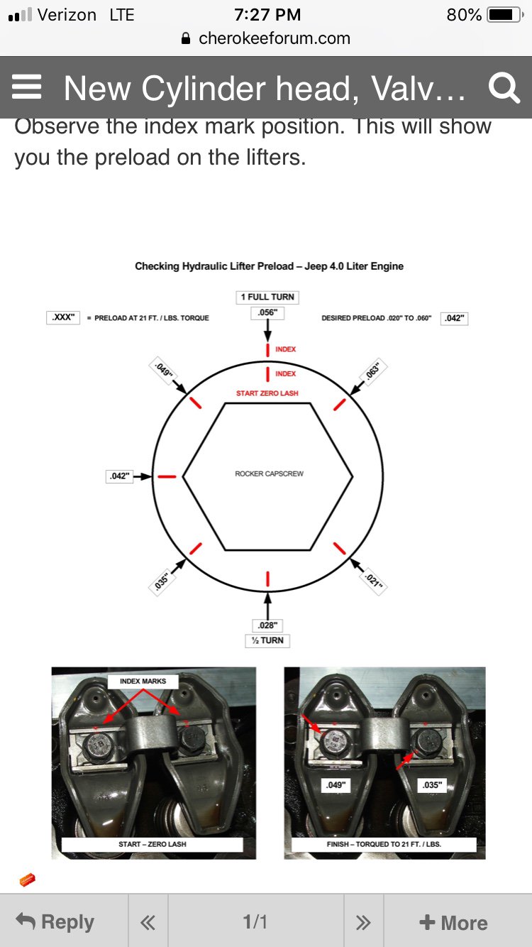

Here’s a link that’ll explain it a little. You can shim the rockers and ,I’m assuming because I’m not fully read on all this, adjust your torque spec slightly to get more or less preload on your lifters. Which would be lashing the valves. They just aren’t as easy to do ask a SBC perhaps. I haven’t done this personally, but it’s worth a shot because over the course of those miles I’m sure it has worn some of the mating surfaces which has freed up some tolerances causing your tick. It may be more work than you want to do, but it’s a idea. There are a few part numbers linked in there to shims use to adjust your preload/lash so I’m thinking it’ll be fairly easy Jimmy.
Edit: Have you checked the torque that’s on the rockers to make sure they haven’t backed off any in 200k miles? It’s all in how much you want to tinker.
Sorry on my 4.0 by valve adj I meant just adding preload to lifters bc of wear over the years! It def eliminated the tick I had but it's just masking another issue my Zj wasn't daily driven!

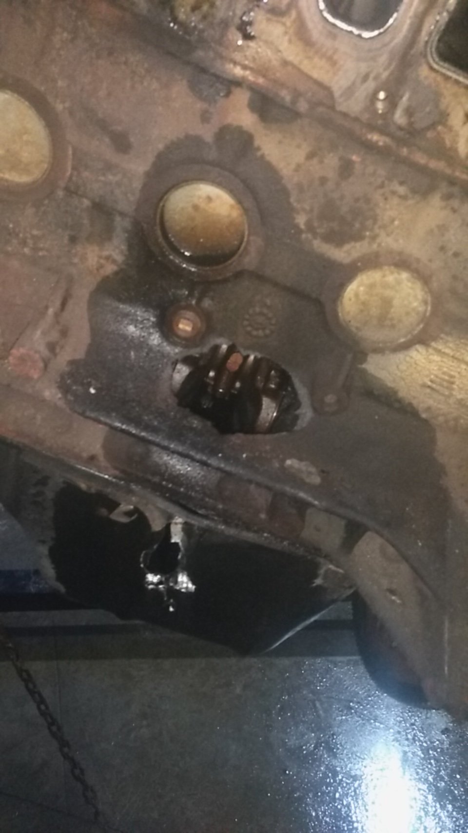

Damn that's an exact picture of my 4.0. When it let loose... lol shit of it is that damn thing still ran after hole that size in block! I loaded on trailer and unloaded under own power sparks and really loud knocking did occur!
A friend on mine in the automotive program at fayetteville tech had a 92 yj. He hydrolocked it in a mud hole on Ft Bragg. It looked just like that pic too. He was broke so we welded the crack on the other side of the block and welded a 1/4ĺ plate on the inside of the hole with a nickle rod. We did all the machine work in class for a grade and rebuilt the 4.0. Last I talked to him 3 years after graduation he was still driving it and had 30000 miles on it.
