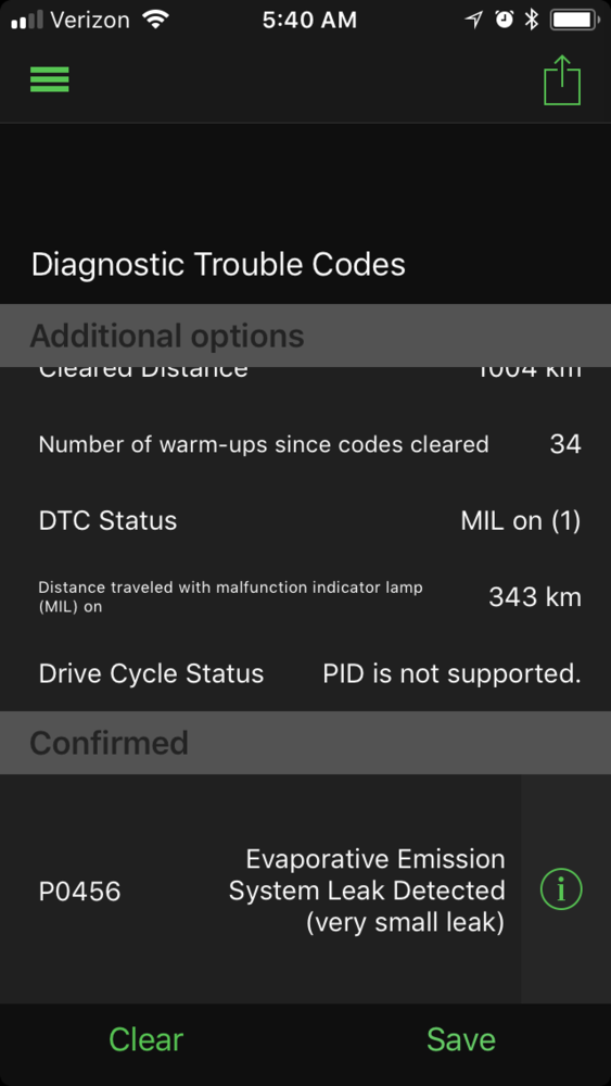

Because my husband has so awesomely trained our bulldog to only wake ME up in the morning..I went out with my reader..here is what I got. Ignore that the readingfor miles is in km
P0456 ..anything I should know this code other than.
It could be the gas cap? Or some other thing that has to be fixed? Like I said still under warranty but I don’t want to keep having the same issue lol and I’m overly paranoid about getting screwed from a dealership shop.
What do you guys think? (I’m aware I’m more than likely overly paranoid) lol
Likely something else but the guys at the parts stores would love to sell you a new gas cap. Without a smoke machine, it'd probably take forever to find.
Yeah. Gonna let the dealership deal with it. :/
Yep, to find it properly it's going to take a shop with a smoke machine. Three most common causes are gascap, leak detection pump, or a split rubber hose in no particular order.
Since you have a code reader, you could try loosening and retightening the cap and clearing it to see if it was just loose then see if it comes back, but if it does take it to the shop with the light on so they can see freeze frame data (freeze frame data is a snapshot of sensor readings when the light came on, kind of like a black box on an airplane)
That code won't hurt anything if you leave it on and drive, it just means the jeep is putting gas fumes into the air (polluting) similar to an 80s or older car would. You won't be doing any damage to the jeep if you needed to drive it a week or so before taking it to a shop.

welp...it wasn't just the gas cap.
some direct line to the fuel tank is cracked, and it requires new lines, and a new gas tank....
