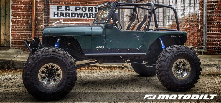

No there is not. This Jeep YJ has the 4 link system installed on it as you can see it provides for a smooth transition to the links. The key is a smooth flat bottom. This way there are no edges or points to get caught and hang you up.

I really like most of your stuff you make, but I don't understand the part of this statement. The whole thing can hang you up now since it sits 3ish" below the frame rail. The smoothness of the underbody doesn't matter if it hits a rock because it is hanging low and stops you.

Typically on a stock skid plate there are edges and this is what you get caught up on. I have been on many obstacles where my skid plate hit but because I had a smooth bottom I was able to slide over them where as my old skid plate would have gotten hung up on the lip or edge. It is no lower then the stock skid but now it is completely flat with no edges to grab onto. There are some suspension kits out there that have a flat belly but the link mount is not as in it hangs down below the frame rail. This then acts like a hook and you get snagged.
There is validity to all points being made here. I personally prefer the flat skid, because when I webwheel, I get high centered more often than I get hung up on the link mounts. But having the mount below the frame allows for better link packaging and flatter suspension geometry, which is also a good thing. I don't think you can go wrong either way, and theres my $0.002.
