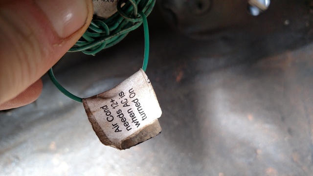

help plz - I hate to tie up Jims time for something trivial. My harness from him is so old that the markers are faded. I lost the wire that revs the motor when the OBA (old A/C Compressor) comes on. It used to work but in an old trail fix it got cut somehow. Also, is this input a 12v + input or 12v -? Seeing as all of the outputs are 12v -. motor is 6.0/ cable pull / manual trans
Hopefully its the same color, if not I'll pull the red plug and see what pin it is.
ai552.photobucket.com_albums_jj335_jrhxj1_Mobile_20Uploads_IMG_20150318_162255649_zpszzfzl4ox.jpg
The AC trigger wire on my Silverado is a light green as well, just for reference.
