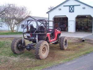

We have a 30x30 that we share with my dad (tractors and farm equipment work) and having the ceilings taller is something i wish we had done. Lighting is KEY. It sucks if you are working at night and cant see to find the tools around the shop. We used 5 huge lights that were extras from building a mall parking lot and they are amazing. Also, put the dang air compressor outside. We actualy put ours in the barn beside the shop. Build a shed out back or the noise will kill you.
Big roll up doors are your friend.
Here is the shop in the background...

In addition a little extra width is nice. It's nice to have some room between cars to walk around and move equipment. The pic by farmboy looked like an ideal sized shop. Ilikeitalot.
