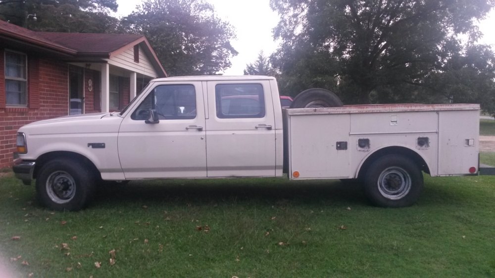

doing the body on this f250 is different than what I did with Nellie. I'm wanting this to be a better quality job since I'll be driving it quit often soooo...
I picked up a orbital sander and have started working on the bed sides. No rust to speak of on the skin but does have alot of chips in the paint from gravel roads. I haven't made up my mind yet if I'm keeping her the same color but am leaning that way.I'm spraying the places down with self etching primer where I have taken the paint to metal. Is it ok to spray this kind of primer over the scuffed up paint so whatever I decide to do paint wise,I'm covered? The original paint isn't peeling but is thin and scratched deep in places plus with lots of chips down low.
I'm thinking of taking the bottom one inch and the roll under of the bed and doing it with black bed liner just for protection from rocks being kicked up off the tires. I'm gonna do liquid bed liner in the bed also.

Now let's talk paint.I don't need a showcar shine paint job. Looking ofr a good quality paint that is easy to put on,readily available,not too terribly expensive, take a beating. The rustoleum industrial paints have been described as having a look similar to the automotive paints of the 60s and 70s in shine. That is all I need. The truck is painted a real lite tannishcolor...and you don't see yourself in it.If I was to paint it another color, it would be rocklobster red that wranglers came in in 2013 but don't see that happening.
the f250 is the same color as Ole Unit 10 and as you see,it isn't mirror shine with clear coat. This is what I am looking for.
