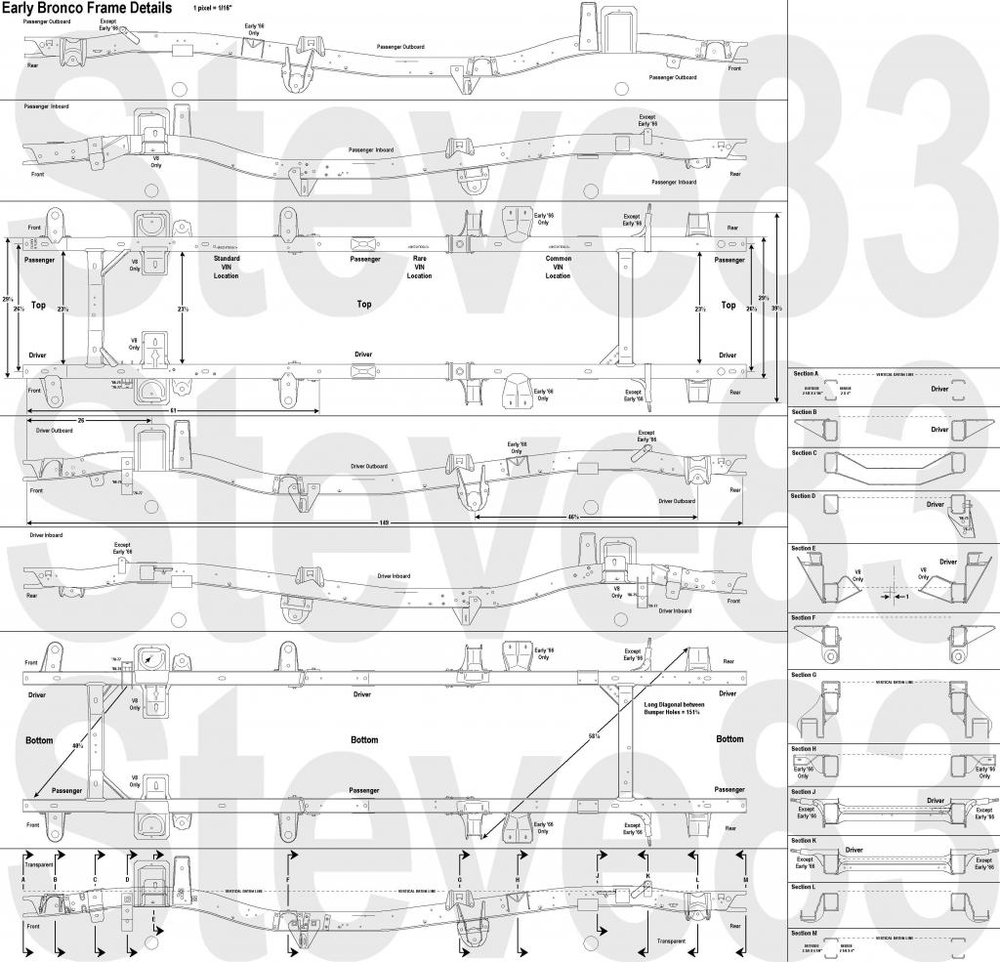

This topic gets brought up on the bronco forums all the time since the vins on these guys were really funky. Technically EB's vin is only on the frame. The vin on a glove box is a warranty tag that is often misused as an official vin. Vin are not suppose to be removable and the glove box door comes right off. Because of this some states have the warranty tag as a vin in there systems. NC inspectors generally look for both and the door jam tag on the 69-77 models, so it can be a fun on the 66-68 models that just have the 2 tags. Also technically all you need is a title and frame with vin, a door tag and warranty tag are can be replicated legally.
