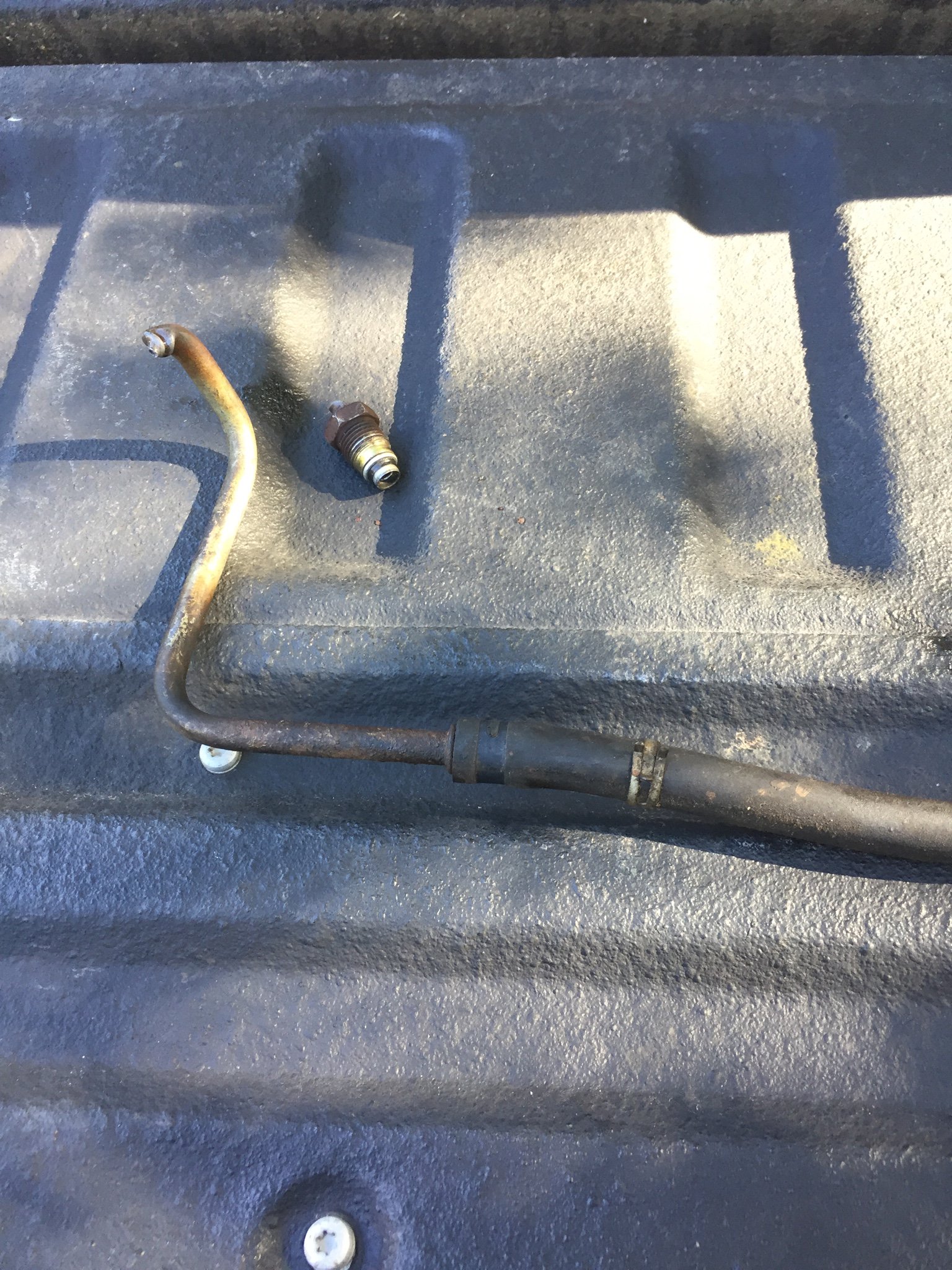

I’m trying to replace my power steering gearbox. Well the return line seized and broke. Well the parts stores only show the rubber hose. So does anyone know where get metal end. Or does anyone know the fitting size and i can concert it to a -6 an line and use a push lock hose?
If you look up the power steering box on rock auto it lists the return line thread as 16mm x 1.5. I am pretty sure that is the same thread coming out of the pump. Can you take the pressure line loose from the pump and see if it screws into the return on the box?

I was kinda thing they would be similar. The only I think could be different would rubber hose length due to reservoir location.
