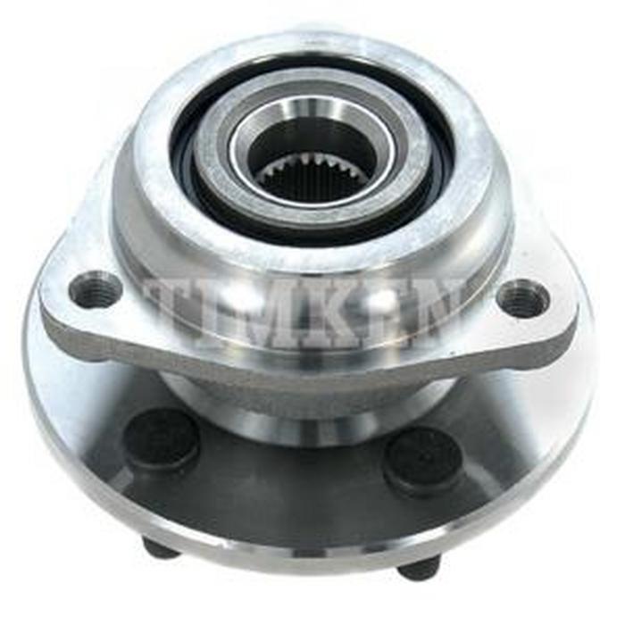

We had the same problem on our YJ
It was the Unit bearings in the D30. When we took them off they fell in the floor.
While your there U-joints are cheap.

what is a unit bearing?
do you mean wheel bearing? pinion bearing? carrier bearing?
Im not sure what you mean by unit bearing.. I live in washington also, maby you could stop by and take a look at it
Joe Clark
Unit bearing or Wheel Bearing
maby it is coming from the front, it really sounded like it was a rear problem, but as short as jeeps are who knows where the sound was coming from.
I suspect that if the unit bearing is bad I should be able to tell it by examining the play in the wheel with it lifted up off the ground..

Yeah, you should be able to feel play in them when a unit bearing goes.

Keep an eye out for gear oil on your rear tires, If it is a rear wheel bearing you will see oil on the tire as the bearing is starting to mess up the seal. That will also tell you which side is bad, But you should replace them both if ones bad, There like $10 each.
wheel beraing
be careful as the wheel bearing can and will lock up, wouldnt want to be going fast when it does. just replaced one on a freinds tj two weeks ago, it would barely roll it had gotten so bad, only noticed it for about a week before we had to take action so it could be driven. she got hers at advance it believe.
