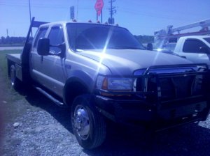

OK, so I figured I would start a build thread for my new(to me) tow rig. A 1999 Ford F-550 XLT Crew Cab Flat Bed. I've been wanting to build a Fummins truck and Kyle(cumminsdzl) found this one for me. So, I sold my Dodge('03 3500 dually) and bought this in Oklahoma.
Initially, when I bought it, I was told that it needed an engine and a transmission(they were wrong lol). I talked to the garage that had hauled the truck in and asked them to poke around and see if they could figure out what's wrong with it, they did.:huggy: So I flew out and drove it home:driver:. Well, they almost fixed it..it took 12 gallons of oil to get home. So, I got it home and got it fixed...8 new injectors. Apparently, the people who owned the truck before me had already been chasing the oil gremlin. They had already put in a new turbo, new under valve cover harnesses, 3 new injectors and a few other misc pieces. :lol:

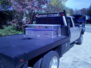

I also came across a REALLY nice 91 gallon RDS aux tank/toolbox combo. closest one I could find->http://www2.northerntool.com/fuel-transfer-lubrication/auxiliary-fuel-tanks/item-3490024.htm

I like that fancy blue fuel tank mounting system. How much did something like that set you back:flipoff2:
What size tires are on the current 19.5s? Are they 225s or 245s?
Dick. It's bolted down and plumbed in now. I'm going to redo the existing filler neck because for some reason, Ford put the small nozzle neck in it.

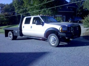

More stuff I've done lol
It had quite a few out the lights out; clearance lights, bedside lights, tail lights, and tag marker lights. So, what to do? Get rid of them all and replace with LED's.
The clearance lights were replaced with '03-'07 Recon LED lights. Reason...they don't make a LED direct replacement for the 99-04 SD trucks.
The upper headache rack lights were replaced with 3x6 Red LED's. I'm not a fan of the clear LED's. The side and back lights were changed to 2" round LED's. Red and amber respectively. And I replaced the tail lights with LED trailer lights
