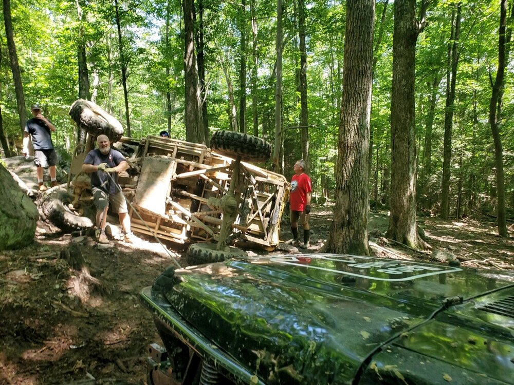

On mine, I rolled at Harlan and I had gear oil pour all over me. I got new shifter boots and I removed the stock vent drilled and tapped for a larger AN fitting and ran a vent line. I havent gotten gear oil on me since. I'll try and get a pic soon.
