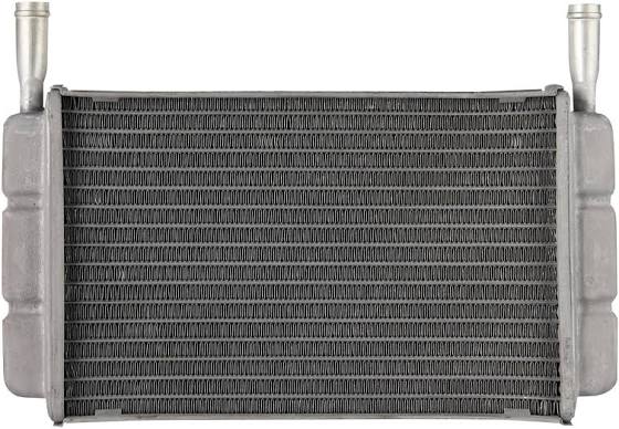

You could just get a heater core for say a ,78 Merc Grand Marq, make a box & add a blower, add ducts as needed. It's a pretty cheap core and rectangular, lines both come straight out the same side, easy to do..
$30 online, not much more through advance
