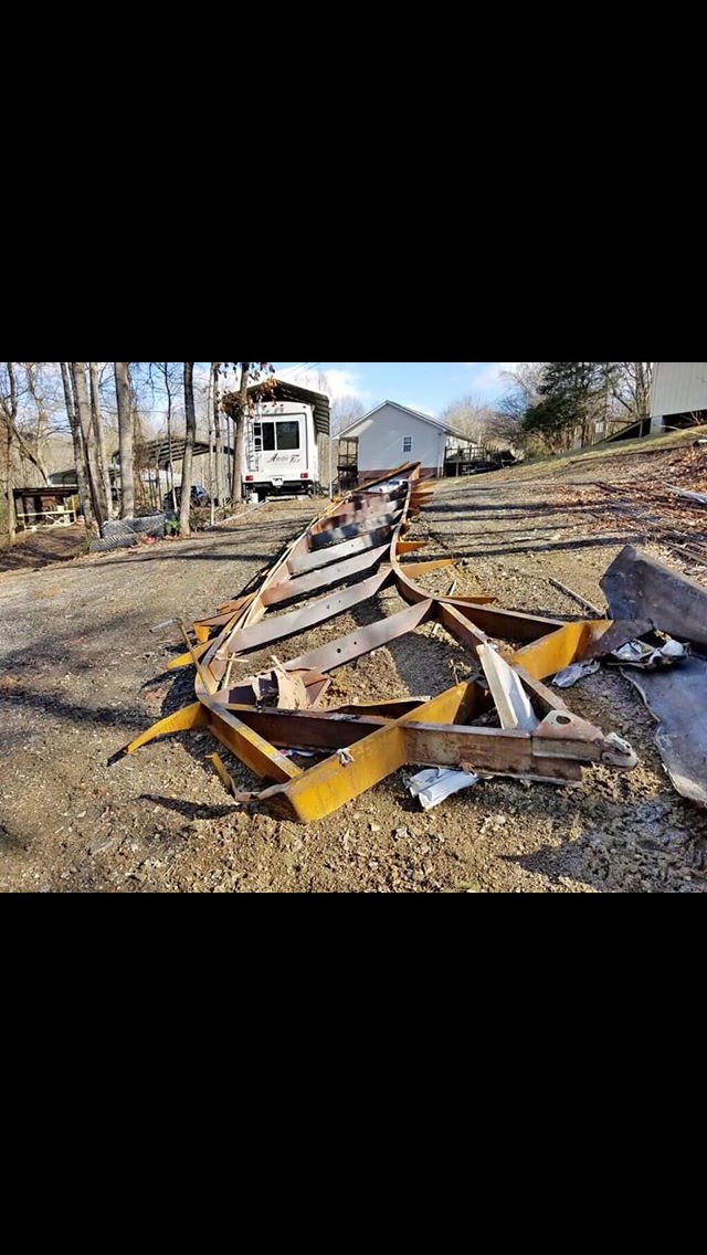

Honest question...what is the structure of the camper frame made of? Camper frames aren't really up to the task of carrying a truck/jeep/buggy weight.
2x3 12g tubing. Tongue section is thicker,
I added all those braces so far. It's just like the other buggy trailer I made but only 1 6k axle rather than 2 3500.
Another honest question:
Are you confident in the material being strong enough to handle the load of carrying a vehicle at speed? Also, what are your thoughts on the placement of the main rails in relation to trailers designed for hauling 4000-5000# cars?

well I've looked up a lot of info on camper trailers before I bought the other one and it's a popular thing so that's why I used one for the last trailer (which held up just fine with that heavy buggy on it) so I was figuring this one would too once I added bracing everywhere like I did and made sides for it just like the last trailer. I'm no trailer or metal expert by far but from lots of reading I've done, it works.

just for the sake of argument since it has a 6000 pound axle doesn't that technically mean the 2x 3 tubing of the frame can handle 6000 lbs? I'm more trying to learn a little about all this not arguing
There's a ton of information missing again to answer this fully unfortunately... One could argue "yes" or "no", depending on load distribution and dynamics....If you had 6000 lbs evenly distributed across that trailer frame with COG right over the axle, it could possibly work. BUT, (that huge "but" was intentional) if you had a single axle and had 6000 lbs distributed across 2 points (looking from a side view of the trailer) -- for the sake of argument, say you had a 50/50 weight distribution on your rig, so you have 3000 lbs each fore and aft of the axle, distance being whatever your wheelbase of your rig is... You're asking a lot of a 2x3" cross section of tubing with a touch under 1/8" wall thickness. Depending on where your leaf spring mounts are, and looking at what the I-moment of that tubing is...I'd be skeptical. With tandem axles, I'd say "maybe." But it still would sorta give me the willies...and I've been known to overload a trailer a time or two in my day. Just ask @Croatan_Kid :lol: Ain't that right, Jake?
