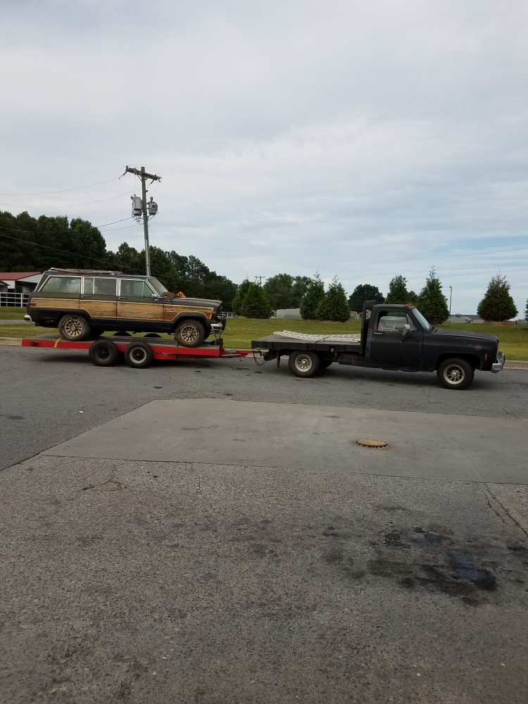

Picture of said truck, doing exactly what I plan to do with it.

Realistically, itll drag my waggy around or any other junk I decide to bring home.
