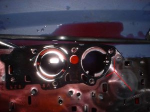

After the first comment of 'are you sure its soposed to do that' i knew things wouldn't end up well.. So fast forward to now. I pulled the valve body down and started looking at things..
1) It looks like the 2nd band was not centered up correctly and apply pin was not hitting the ramp on the band, but hitting a flat part where its likely it wouldn't be able to push it.. combined with...
2) 4th gear accumulator gasket completely not correct installed right. half of it was in the hole.. (see pic). Im not sure when fluid flows there but i know that any time something not in the right spot it can affect other stuff...
3) Valve body seperator plate - Very sloppy install of the shift kit. Where he drilled out holes in the plate to increase pressures there was still burrs on the plate, enough to cut your self.. He chamfered the wrong spot, not sure what feed that is, may not hurt anything but again in know enlarging the shift holes from .085-> .096 = hugh difference in shifts.. So if enlarging somthing else can bleed pressure maybe its also contributing to the 2nd apply issue..
